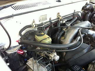

Name:	oil catch can.jpg
                      i just did mine but i experince a wizzing sound coming from the oil catch can....my mech says its due to the 90 sereis is not common-rail engine...so im thinking of uninstalling the oil catch can
                      Prado 95 3.0D Turbo Auto Series 1997, 285/70/16 Bridgestones AT 694's on 16x8 rims
                        Originally posted by Prado91 View Post
                        [ATTACH=CONFIG]7324[/ATTACH]
                        Leave it there for a couple of months and see what it catches. You might change your mind after that.
                        Steve.
