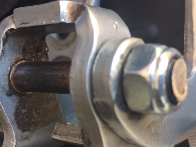

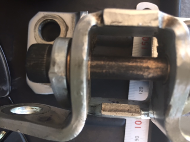

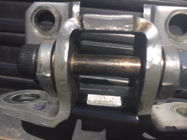

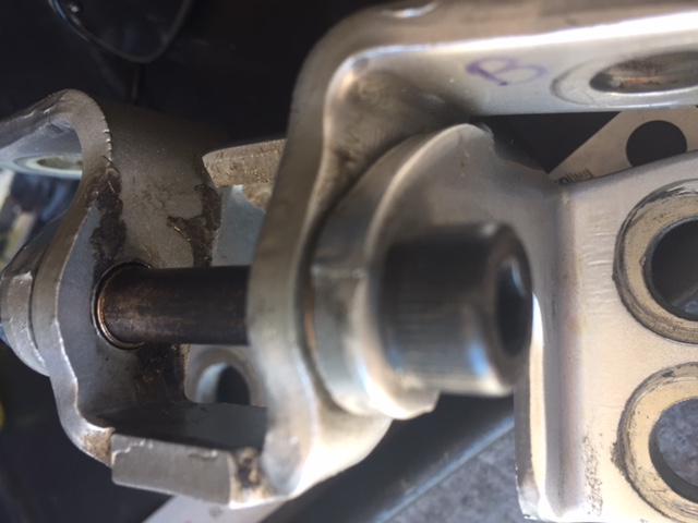

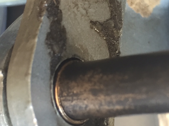

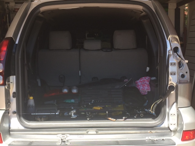

                            During a trip up Duck Creek Road some months ago a new sound in the back of the car caught my attention. I would get a 'thump' sound whenever I turned a corner. After some investigation I discovered the rear door hinge lost one of its plastic bushes and the door would move up and down as it shifted under its weight.
                            Fix.
                            New genuine hinges $110.00 each with the potential to have the same issue be it some years down the track.
                            I opted to take mine to an engineering company. Pins removed, new brass bushes made and new pins.
                            Result is a much stronger longer lasting serviceable hinge. Cost was less than genuine (I would rather Graeme priced it for you)
                            Hope this helps others who are after a permanent fix.
                            No affiliation just loved the service, speed and quality of work.
                            GJR Engineering
                            Graeme
                            7 Pendrey Ct, Woodridge QLD 4114
                            (07) 3299 5411

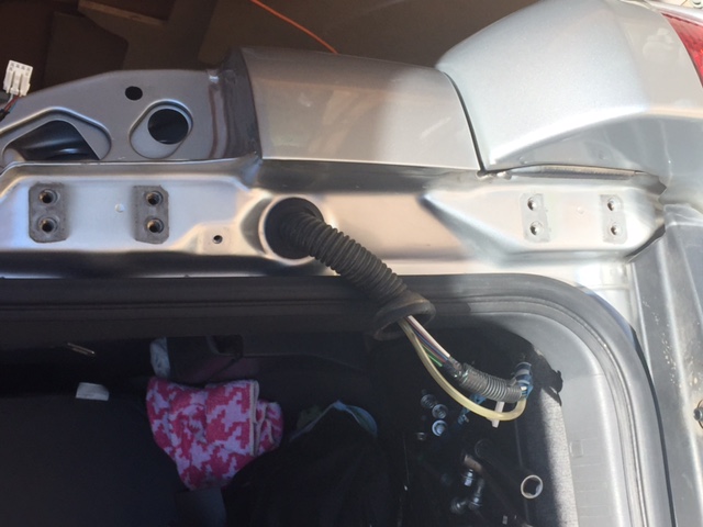

                                Hazza, I can't find many who have actually taken the hinges off.
                                I'm keen to replace with new hinges.
                                Do you think it's possible to support weight of door and replace the hinges one at time?
                                I'm not sure I can figure how to get full access to bottom hinge?
                                Is your new pin simply an allen head bold and nylock nut?
                                I'm thinking to replace with new hinges, and if they wear quickly I'll get the old ones rebushed.
