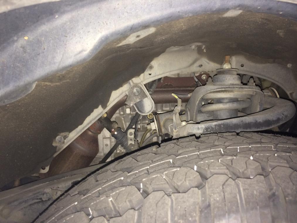

                          Fantastic timmy! Excactly what I was looking for. Thank you!
                          I searched the forum but did not think of searching for "plastic skirt"
                          That's what it looks like just to confirm we mean the same thing.
                                Click image for larger version. Name: photo.jpg Views: 14 Size: 89.7 KB ID: 16810
                                Yep that's it!
