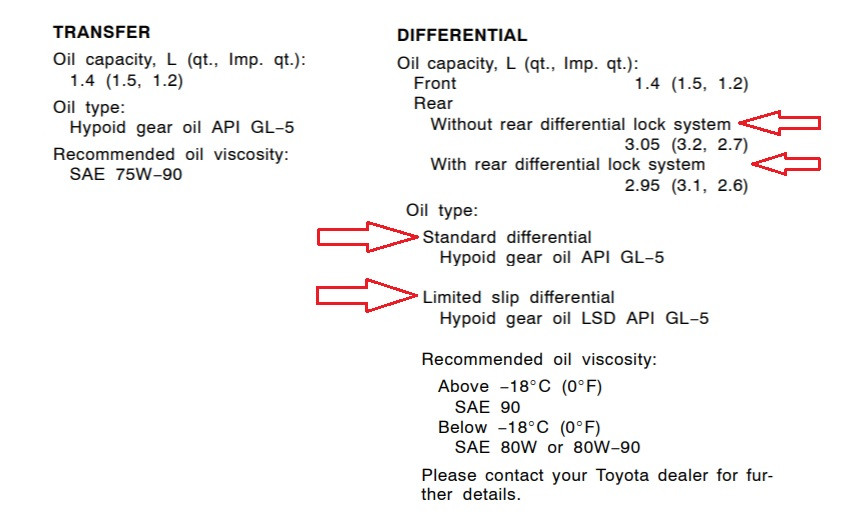

    Hey Guys
    I have a 4 x 4 Toyota Prado 2007 four (4) cylinder 2TR-FE Gasoline Engine 2.7 Automatic transmission.
    I want to change the Transfer and Differential (Front & Rear) Fluid as maintenance.
    I was checking the Toyota manual and I am a little confused because its say that it use different fluids if I have a Standard Differential or a Limited Slip Differential
    How do I know what type of differential I have?
    Can you advise what oil type to get?
    Thx & Rgds

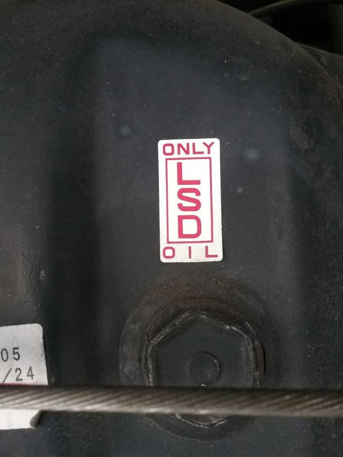

      There's a label on the diff if it's LSD
      Click image for larger version  Name:	attachment.jfif Views:	0 Size:	53.2 KB ID:	756048
