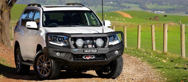

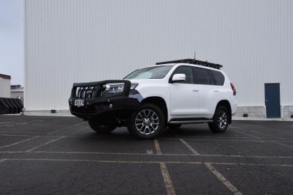

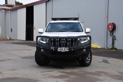

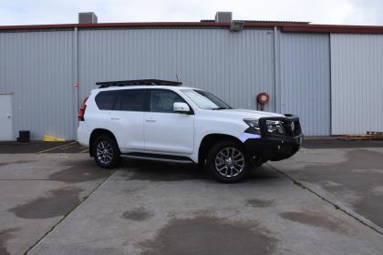

              I'm now strongly considering getting a Smartbar for my 2018 Prado, however the picture of the 2018 smart bar on the ARB website does not look overly appealing. I've since spoken to Smartbar and they have emailed me some other photos from different angles (see below). I'm still not sure if I'm a huge fan of the new design. It does not appear to be as contoured/slimline as the previous models.
              If you're interested I also have the PDF file of the 2018 Smartbar specifications. The file is only 5MB in size, however it is too large to upload here. I can email it to you if you like.
              The reason I'm considering purchasing the Smartbar is due to its lighter weight - it won't increase my GVM too much, therefore allowing extra room for increased towing weight.
              ARB 2018 website Image

              2018 150 series Smartbar. They emailed me these extra images.
