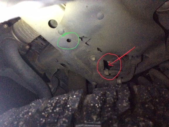

              Hi guys. Reopening this one. I have a 2015 3.0 150 series VX pre facelift. Toyota nudge bar (no bull bar)
              i just received some recovery points - same as in this thread. I’ve seen a few vids on installation, which looked ok, but....
              - when I line up the driver’s side, no issues. Holes obvious. Rectangular slot to insert “nut on a wire” for unthreaded top bolt obvious. All good.

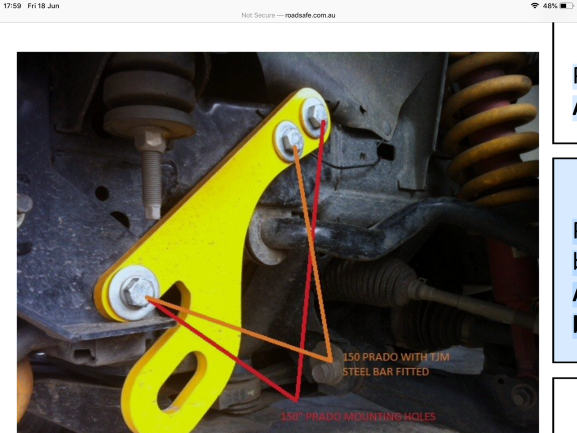

              - on the passenger side, there’s stuff everywhere! The threaded bottom hole is again obvious. At the top, however, there is some sort of bracket with some pipes - is this something to do with the VX suspension setup? There is also a rubbery cover in situ. Thing is, I can’t see anything resembling a slot for the top “nut on a wire”. I THINK the top bolt goes through the hole near the letters “KL”? See green circle. I am guessing the hole for the “nut on a wire” is the one circled in red?? This side all looks very different....Anyone encountered this? I’ll add the pic from the manufacturer for comparison.
              I’ll try to get better pics with recovery plates lined up for reference tomorrow.
              Cheers, Mat

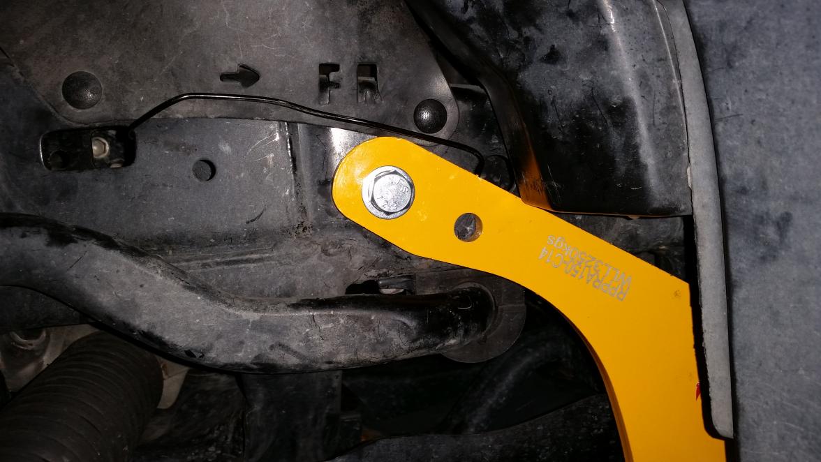

                Quick update should it be useful to others...
                - as expected the driver’s side was easy (yes, the “nut on a wire” is fiddly. Involves one becoming a Yoga Master.
                - the passenger was actually fine, once I’d figured the approach. All the extra bits I thought would make it hard were actually out of the way. I also chose to just leave the rubbery cover guard thing (with "KL" stamped in it) in place and bolt the recovery point over the top of it. It only overlapped on a small edge near the top recovery point bolt, and didn't seem to disrupt anything. I figured this was easier than trying to pull the "KL" flap away, and then have it flapping in the breeze. This side needed a bit more bending of the wire to match it up.
                - I've left the wires showing in the pics for reference. Actually, I think I'll just tuck them in rather than cut them, in case I need to remove the recovery points in future to maybe fit a bullbar. They seem to tuck away safely.
                - I was lucky to have morning sun on the job, so it really helped to be able to see the threads of the nut-on-a-wire through the hole. Highly recommend a movable light on a stand (or similar) to get just the right angle. Also, no chance of a helper - no space! Recommend turning the wheel to either side to open up some more workspace.
                - there was no need to remove anything along the way....
                Mat

                    Thanks for your tips Mat, made the install easier. I bended the wires inside the chassis as well, just enough so I can still pull it out if needed.
