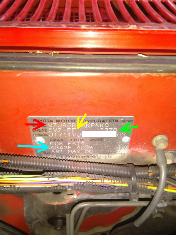

                Joker for avoidance of doubt you could hunt for your manufacturers plate - this contains the trans model. For example here is mine, and the cyan arrow is the transmission model number. Also, do you have a manual mode you can select a gear from - if so just go up and down these.
