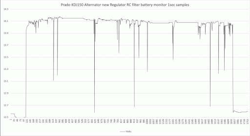

                      Some insight into the battery voltage during a 30-minute trip and data logged at 1sec intervals.
                      I had replaced the Alternator regulator some months ago as the voltage was somewhat lower (13.5V) and erratic. After replacing and cleaning the brushes the regulator seem to correct the erratic and low voltage issues to some extent. As can be seen, the voltage still has low voltage spikes when the alternator is clearly not charging for very short periods while slowing down through the gears (6-speed manual). The ambient temperature was about 18C.
                      I'm still not happy about the low voltage as it takes the smart battery charger some hours to fully charge the battery to 14.6V then drop back down to 13.8V float. I would recommend regular overnight charging of the battery to keep the battery fully charged.
                      It does seem Toyota has a poor strategy for looking after the start battery, no heat shield to protect the battery, no boost charge which is going to fully charge the battery and only some notion of 13.8V float.
