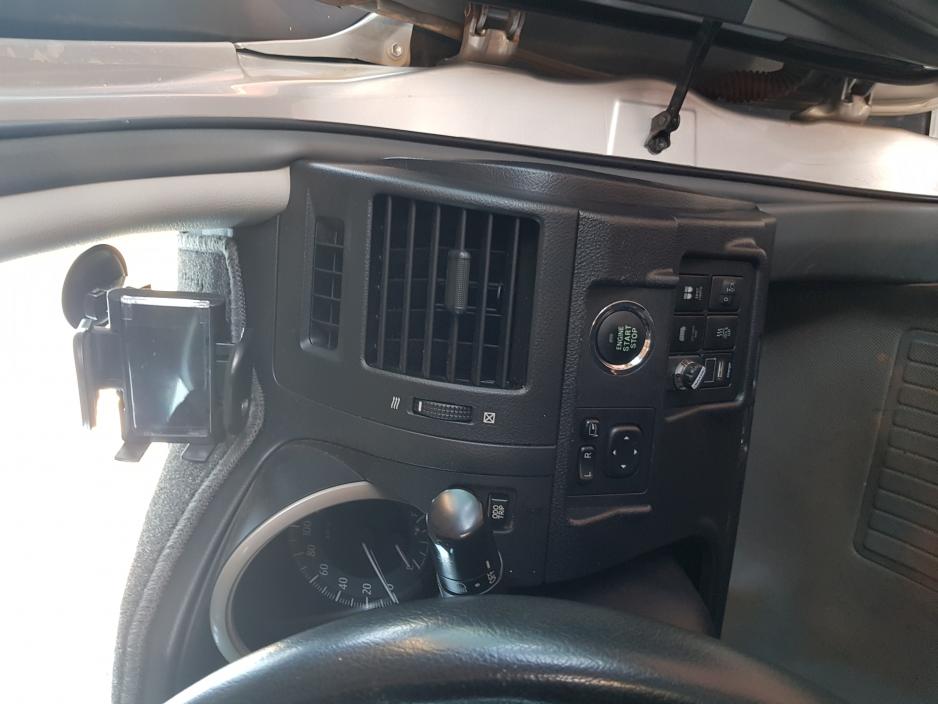

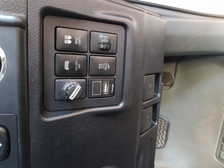

          Cool man thanks, here is a sneak peak at what I am trying to achieve, so my mobile sits in the holder and plugs into the USB below, great location for GPS, maps etc, plus the cord is straight down, I will swap the redarc and USB over before I wire it up. the double USB will go in the centre console when it arrives. For some reason the pictures are not the right way up... Click image for larger version

            There are USB sockets that fit in the 150 switch blanks. Have a look on evilbay. Then it is just a matter of the wiring. Some are rated at very low current so make sure you get what you need.

                  Got it sorted today, used existing wiring to power off, then removed a lot of redundant cables, relays, joiners and plugs, I removed more then I put in LOL, but anyway now I have a USB and amp gauge on the right and a dual USB in the center, works a treat, also I now have a power source to plug any other options I want on demand, the joys of being a 2nd class auto sparky with more pride and passion then the auto sparky that charges $160 an hour...
