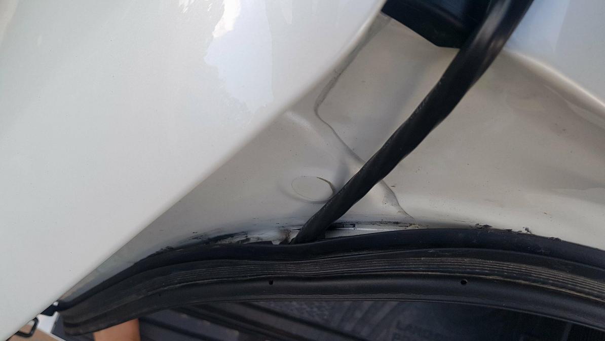

    Can anyone with roof side and or rear lights post some pics or explain where the wiring was routed? Towards the front or the rear? If it was to the rear where did the wiring enter the vehicle?
    I have had some lights and wiring done and I think they picked the worst spot,but it remains to be seen.
    They have put sika in the gap to seal it up but to me that is just pathetic.
    That's very easy for water to get in under the seal and then it will sit at the bottom and rust out the body seam at the bottom part of the seal. Common issue in the 120.
      That is pretty lame. I haven't done rear lights (yet) but I would have...
      taken the wires to the other side of the roof rack
      ran the cable under the short piece of roof rail plastic trim
      then down to the rear door (hinge side) then into the rear door cable grommet and into the cabin.
        Yep !!
          If they wont fix it i will get someone else to do it
            Run cable through grommet behind the light is another good solution.
