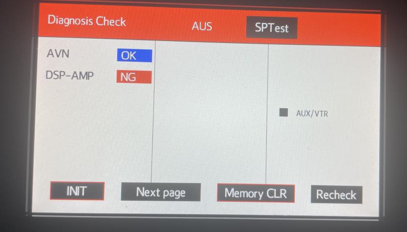

    Some Googling provided information on diagnostics menus so I've just run them today. Perhaps unfortunately, the audio insists on working today, however I have conflicting reports from two different screens which is quite strange. Entering via the <APPS> button & 3 headlights shows DSP-AMP failure, whilst entering via the <AUDIO> button shows DSP-AMP OK.

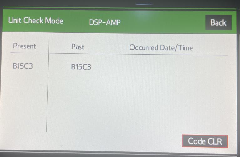

    Managed to catch it not working yesterday. Here's the error code...

                Yeah seems across a number of Toyota and Lexus cars... Speaker Output Short (B15C3)
