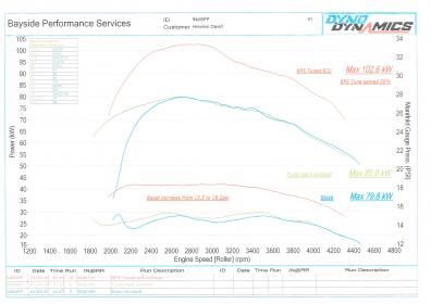

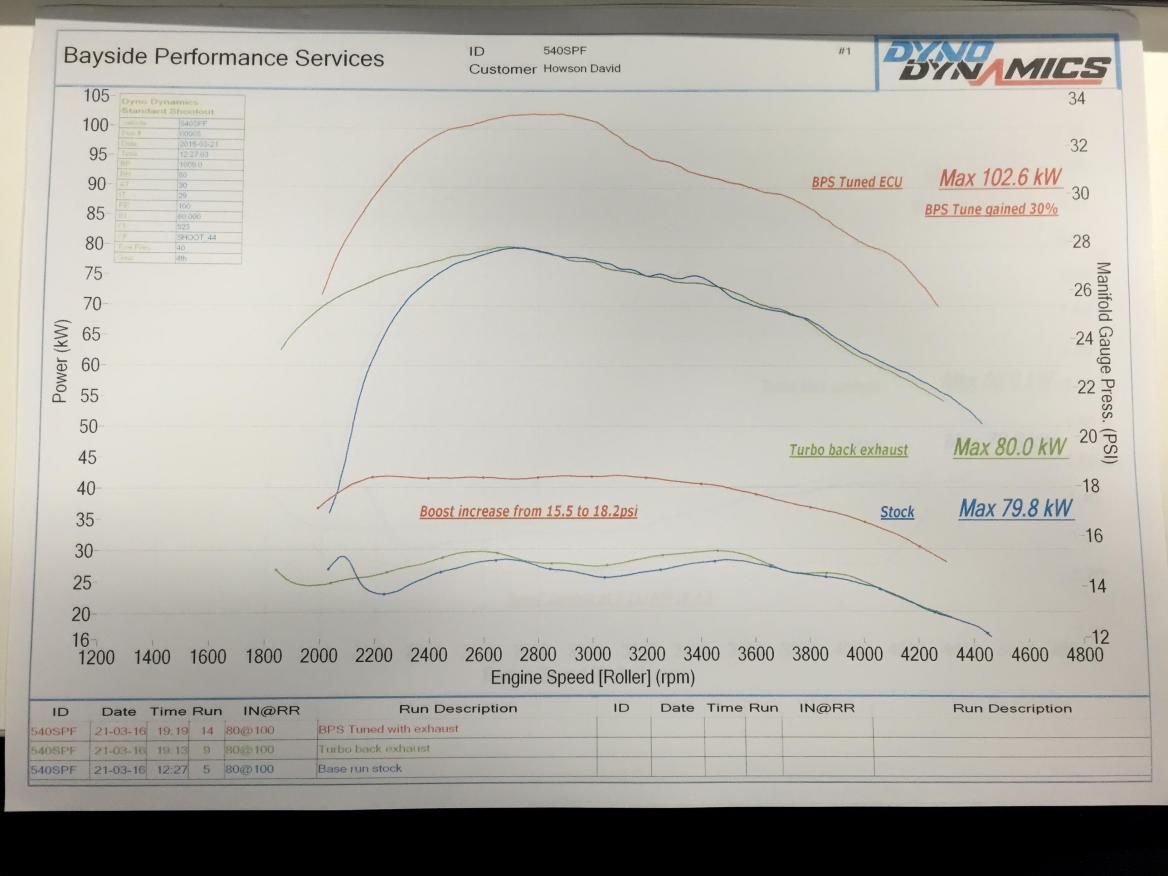

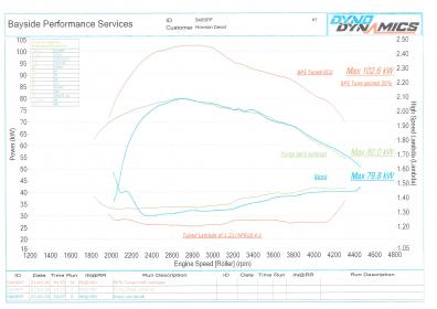

Of course I was not convinced and in order to supply as accurate information to PP users as possible, I came to an agreement with John that we would do three dyno reports. One stock, one with exhaust and one with exhaust and tune all done within the same period. Please keep in mind that I am running Mickey Thompson 265/70-17 atz's. For the benefit of all I have also included the stock tune that BPS did for another of their clients who I understand was running standard tyres.
For clarity John didn't max out the motor as I tow a boat and trailer regularly and I wanted some margin for that purpose. You could push this harder if you really wanted to..
The pipe I chose to go with was a Scott's Rods 3" aluminised exhaust. They came well recomended and provided a good product at a reasonable price.

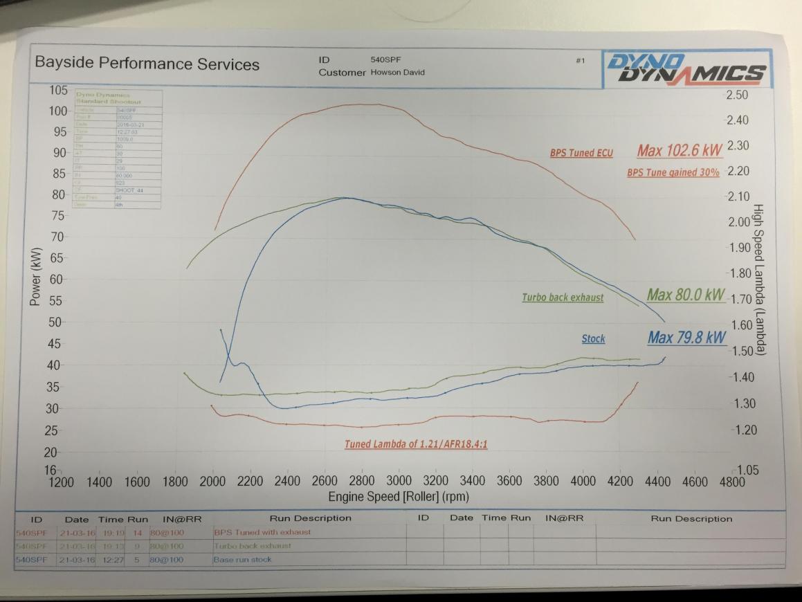

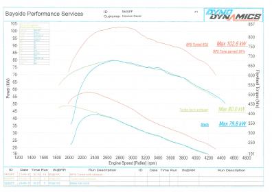

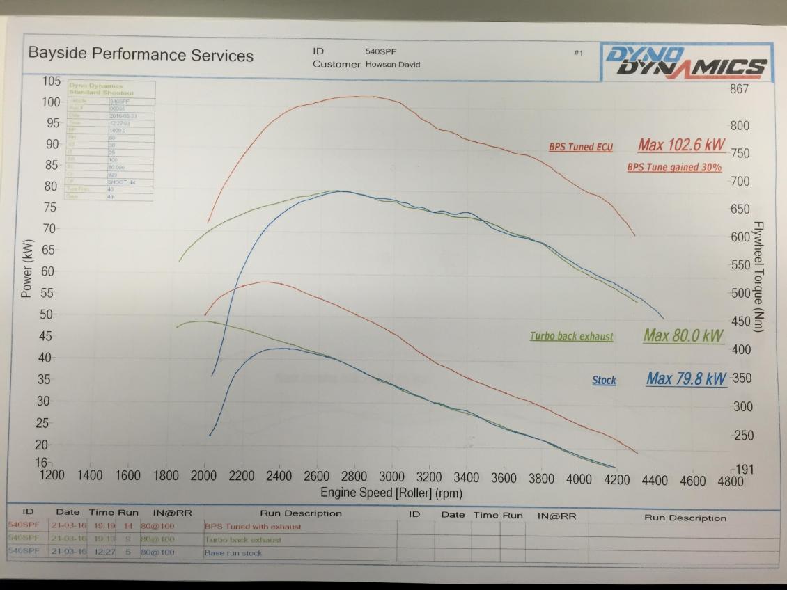

So down to the tin tacks.. Three dyno runs with three different configurations all on the same dyno report. I have included the three versions I was provided to paint as clear a picture as possible.
As you can see the exhaust added little to know gain whatsoever. To be fair John did tell me from the outset but of course I wasn't convinced and wanted to be 100% sure. Whilst there is always conjecture amongst these things I would personally not have gone down this route had I known the result. I would have saved the $900 odd dollars and put it into some other modifications. Anyway for the benefit of the rest of the PP community please use this information as you see fit.

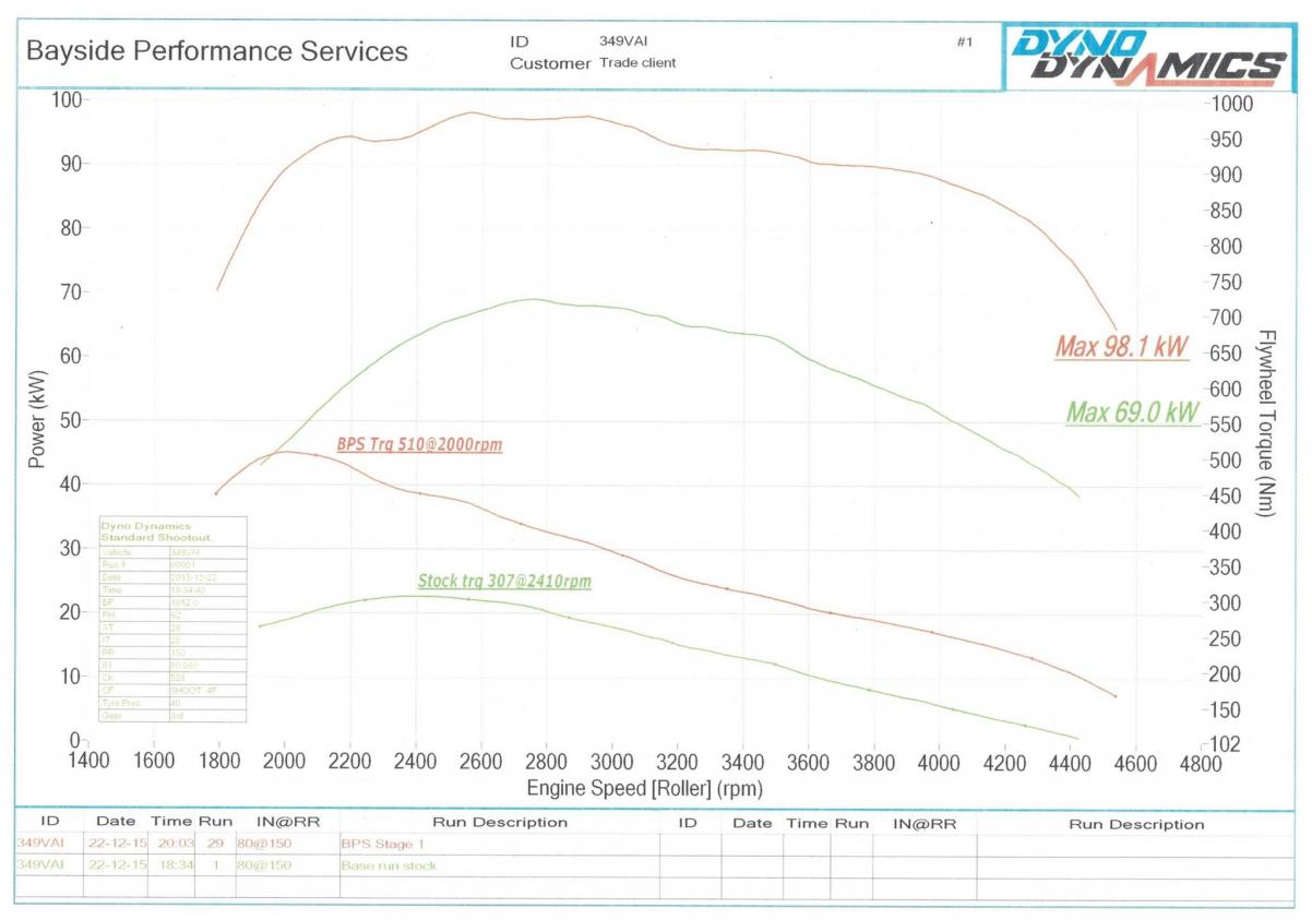

Further to the above I have included below the original Prado re-map (for his other client) that John did before I took my car in. This was done with a completely stock Prado.

Now I am a bit of a stickler for detail and I had read a number of posts offering advice on power gains achieved from exhaust pipes etc. While I was thankful for all the information there was a lot of ambiguity. To be fair I mean no disrespect but I was hard pressed thinking I would fork out my hard earned without having some more detail. I contacted John from BPS and spoke to him about a stock Prado they had done and what kind of results I could expect to achieve. We also discussed the pros/cons of an exhaust increase. John's advice around the Prado was that the stock exhaust was more than suitable and that increasing to a 3" pipe would really provide no substantial gain to his tuning.
