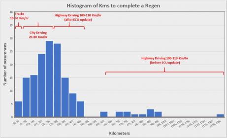

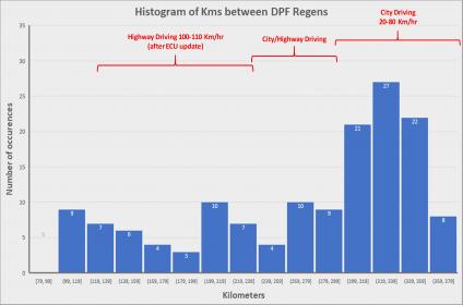

    Here are some DPF stats for 0-50,000Km on my 2018 GXL Prado:
    ECU firmware updated early 2019.
    Kerb Mass ex driver approx 2,700Kg.
    Accessories include GVM Upgrade, Bull-bar, Winch, Twin Wheel Carrier, Drawer System, UHF, Spot Lights, Dual Battery, Tools etc.
    Click image for larger version  Name:	Kms Between Regens V01.jpg Views:	0 Size:	14.9 KB ID:	749740
    Click image for larger version  Name:	Kms to complete a Regen V01.jpg Views:	0 Size:	16.3 KB ID:	749739

    DPF regens at highway speeds (post ECU update):
    Ave Kms to complete a regen = 30+Kms
    Ave Kms between regen = ~150Kms
    Regens often ended at 4% and some at 0%
    DPF regens for city driving:
    Kms to complete a full regen = less than 20Kms
    Kms between regens = 250-300Km
    Regens on remote tracks (5-10-20Kms/hr):
    Kms to complete a full regen = 2-5Kms

    a. trips less than 5-8Km won't produce the conditions for the DPF to start let alone complete burn. This is how long it taken to warm the system up before a regen will start, or resume after interruption.
    b. 5 DPF burns during 5-10-20Km/hr grinds over sand dunes and remote tracks.
    c. the 2019 ECU update significantly reduced the Kms between regens at highway speeds, and significantly reduced the time to complete a regen.
    d. the DPF burn quits at 8% saturation, but the high level of residual heat energy carries the burn to 6%, and sometimes 4% and occasionally all the way to 0%.

            From the data you have provided yuor DPF is partially blocked. The low km's between burns at hwy speed is indicative of that.
            Doug
              Might be, however the ECU update (circa early 2019) changed the burn frequency for highway speeds, but not for city driving.
              You'll notice that before the ECU update the highway burn frequency was the same as for the city cycle, but it was taking significantly longer to complete the burn at highway speeds.
              I assume that the burn takes longer since it has to keep ahead of the soot generation process at 110Km/hr.
              I have the DPF tested every maintenance period, You can do it with Techstream, the pressure differential when the burn is complete is small.
                What parameter are you checking? Is it the Cat differential ?
                I can honestly say with a new DPF the burn is now occuring every 300+km. With the previous DPF and same ECU firmware it was doing it only at 120km to 150km. If you using the Cat Diff value are you seeing 0.05? Thats what the new DPF is showing once burn is complete it does go up as high as 0.18 when at 100%.

                  Hi Cuda,
                  Haven't done any real highway runs since the middle of last year.
                  Subsequent city regens have been occurring between 280 - 360Km. The best at 367Km, most between 320s-mid340Kms.
                  The daily driving scenario is 52Km to work and back on the flat at 40-60-80Km/hr.
                  Completed a 8,500km trip to the Kimberley and back mid last year, just after the ECU upgrade was installed.
                  About 7,000Km at highway speeds (110-130Km/hr [in the NT]). The Prado loaded was 3.05t.
                  The DPF regens occurred at a much higher frequency on the highway, mostly around 150Kms, occasionally 200+Kms.
