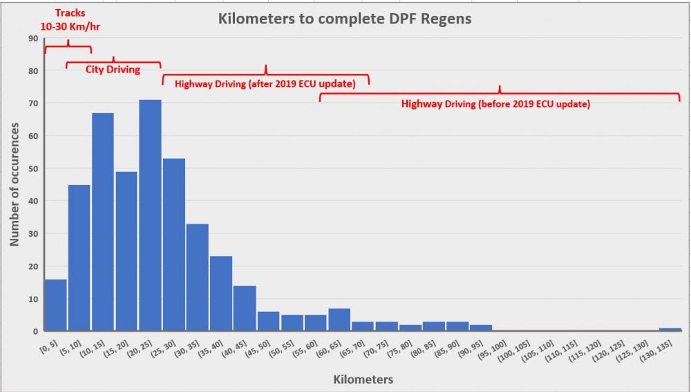

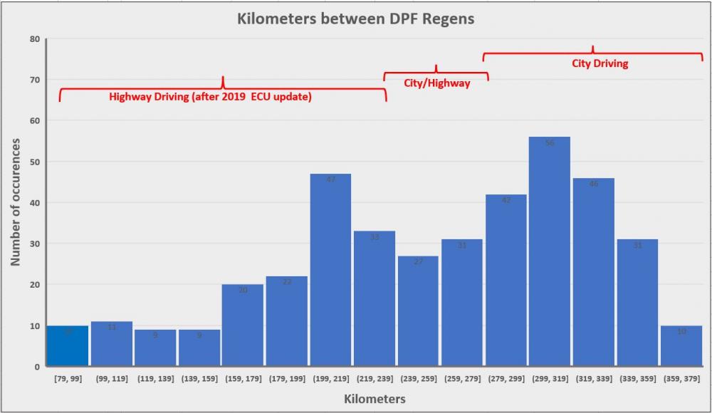

    DPF stats after 100,000Km on 2018 GXL Prado:
    ECU firmware updated early 2019. Both Custom Modes enabled. New DPF installed at 80,000 service (didn't need it, but got it anyway plus 10 year unconditional warranty). Kerb Mass = 2,740Kg+.
    Click image for larger version  Name:	image_26975.jpg Views:	4 Size:	45.7 KB ID:	764811

    a. trips < 5-8Km won't produce the conditions for DPF to start a burn in winter. This is how long it takes to warm the engine to start/resume a regen.
    b. 2019 ECU update significantly reduced the Kms between regens at highway speeds, and significantly reduced the time to complete a regen.
    c. DPF burn quits at 8%, the residual energy carries the burn to 6%, and at times 4%, 2% or 0%.
