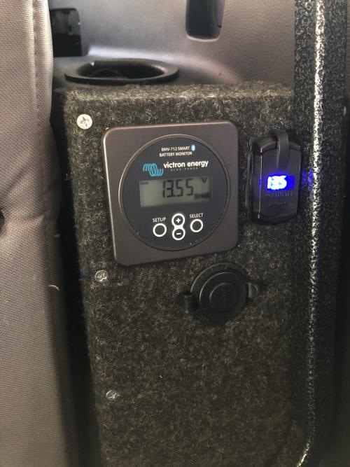

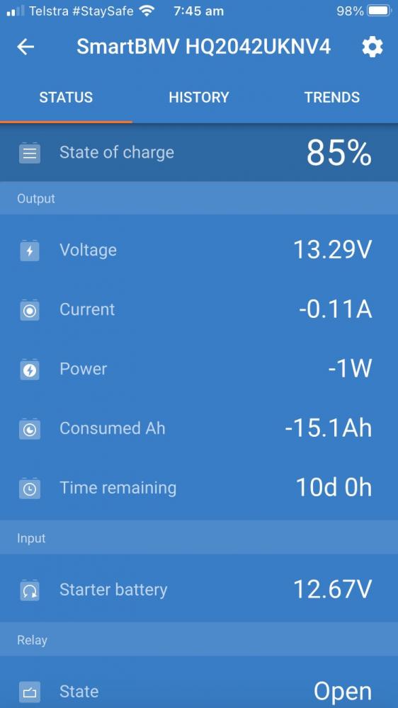

    In the new car (2021) I have set it up differently due to going with LiFePO4 battery for the Aux. Mounting the battery was the first big challenge. Now that is sorted I have this week added Victron BMV-712 monitor. While I managed to get a relatively cheap battery and DCDC charger, I went the other way with the monitor. Figured we’ll have the car for many years and if we look after the Aux battery maybe it will last. Thus far the BMV-712 seems brilliant. I like that you can see how many Ah you have used via bluetooth, and the app is simple yet highly functional.
    Fridge has been on since mid-morning yesterday, battery now at 85%
