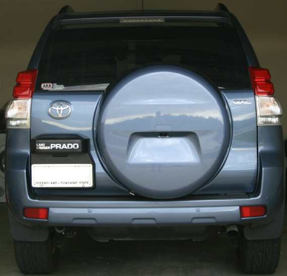

    Hi all, just thought I'd post a small issue that has become evident on my GXL TD Auto, whilst I was out the front yard one day doing the chores, I was admiring the new machine in the garage when to my dismay, I noticed that it appeared to be leaning to one side. Quick measure of the two sides confirmed my suspicions, 10mm height difference from one side to the other, checked for anything heavy in the car - nil - checked fuel load, about 1/4 full, could only come to the conclusion that the suspension on the lift side was sagging. Took it to the dealer I bought it from, they took measurements and said they will contact toyota to check for any known problems to which came the reply "It is within specs". Now this is a vehicle that certainly hasn't had a rough life, one small 4WD jaunt that in all honesty didn't need 4WD and it is still 9,000km young so I certainly wasn't expecting to see any suspension sag till later in life and after it had done some serious work. Maybe time to look at aftermarket suspension, just didn't think I'd be the one to pay for it this early.
    [attachment=0:3gpadzs9]Suspension_1.JPG[/attachment:3gpadzs9]

    I wouldn't call 10mm a "Sag" A lean to the left with fuel load is very common on 90, 120 and 150's (and FJ Cruisers too!)with factory or medium after market springs. Your main tank is on the passenger side, so is the battery.
    This is why aftermarket springs are marked left/right or use trim packers (like ARB) with light/medium springs; to correct the lean.
    Before you stress too much; Jump in the drivers seat and get someone else to measure, assuming you're an average sort of weight it'll level out.

      < 10mmis pretty much accepted as within range, depending on load, vehile set up, fuel load, acessories, gear in car.
