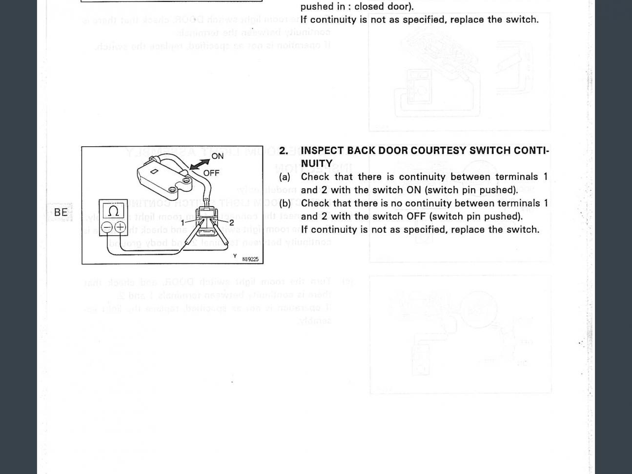

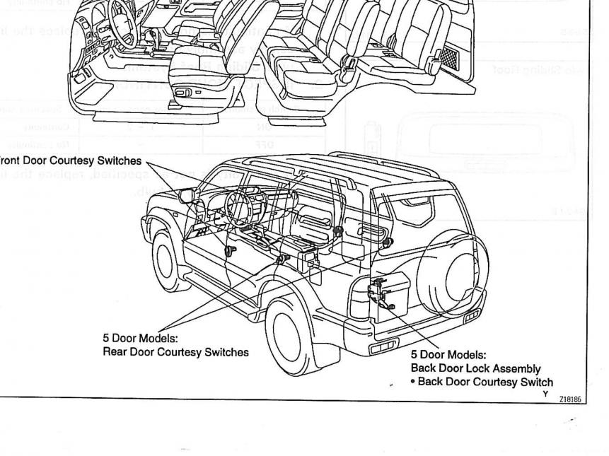

      I think the switch is attached to the latch mechanism in the door itself. Also the wires could be broken through wear and tear where they pass from the door to the main body of the car.
      If the alarm/central locking system receives no signal when you open the back door it will behave as if you unlock it with the remote and don't open any doors and it will lock after 30 seconds.
      Hopefully these pictures will work.
