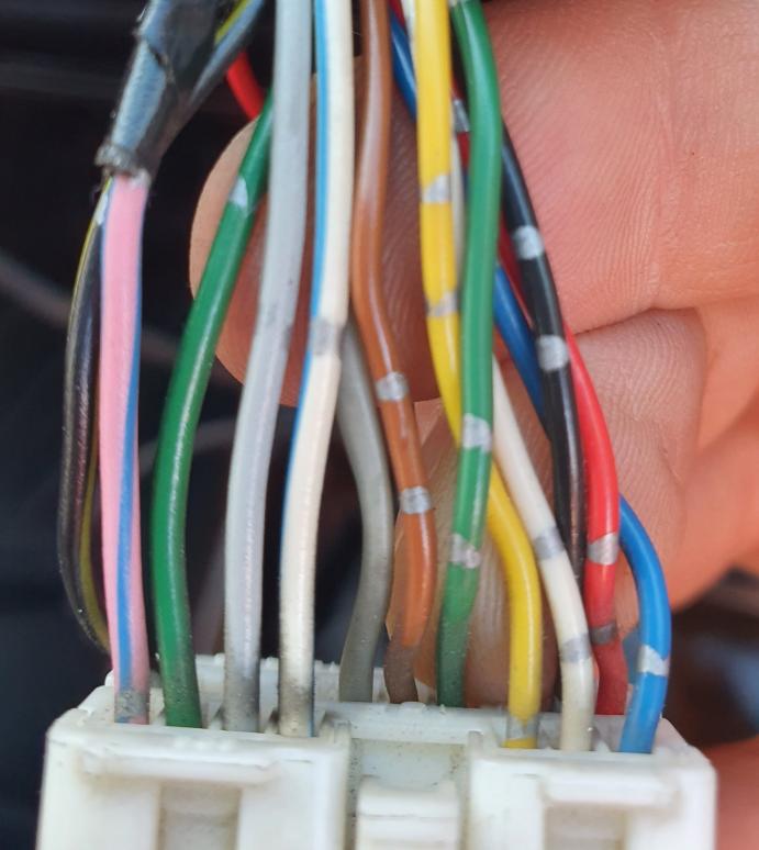

                            Late to the party, but my stereo is nothing like this. Any help with working out what is what would be great!
