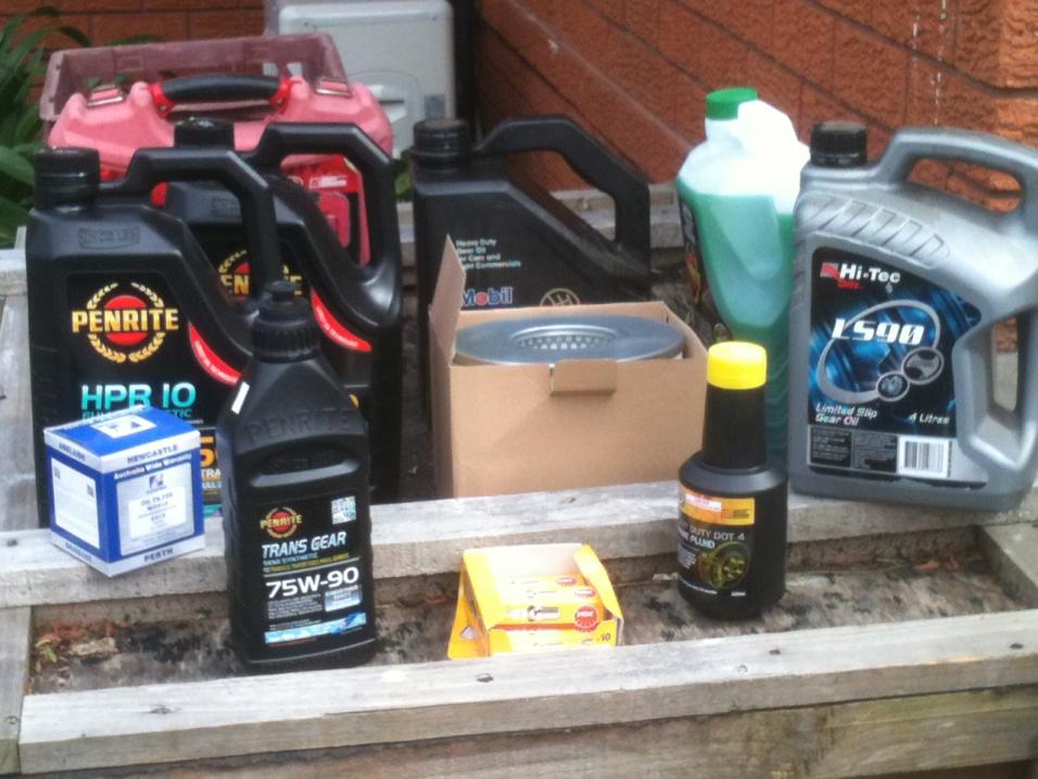

                You really want the oils done by a proper 4WD place or at least someone that will listen to your requirements. The timing belt should be within the ability of most decent mechanics. Check your water pump while the timing belt is boing done, saves a lot of labour of you do the two at once. I did.
                Here's a little pic of what went into mine at the 200,000 service - and you need to add gearbox oil to this,
                and double the transfer case oil as it's a replace and not a top up.
                Took me all day, a proper mechanic should be able to do it all in 4 hours with car on a hoist and all the right tools and stuff.
