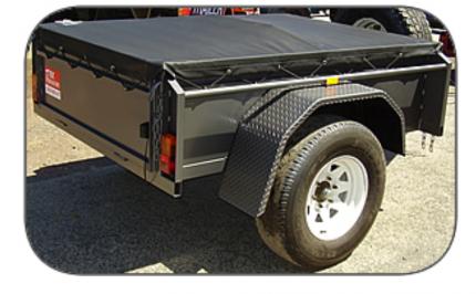

                            Something like this is what I would like. Trik Trailers in Bayswater reckons it would cost btw $3000-$3500.
