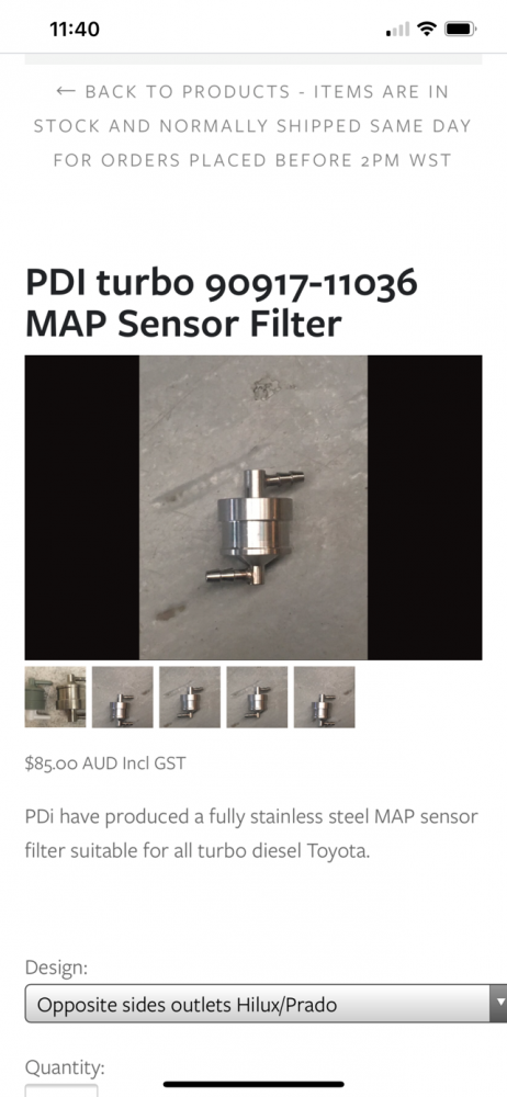

    Found a Stainless Steel replacement filter from PDI
