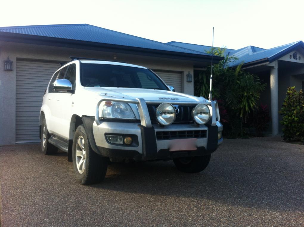

    Ok so i been reading a lot of the build ups on here and many of them are very impressive.
    Anyway I thought I'd start my own

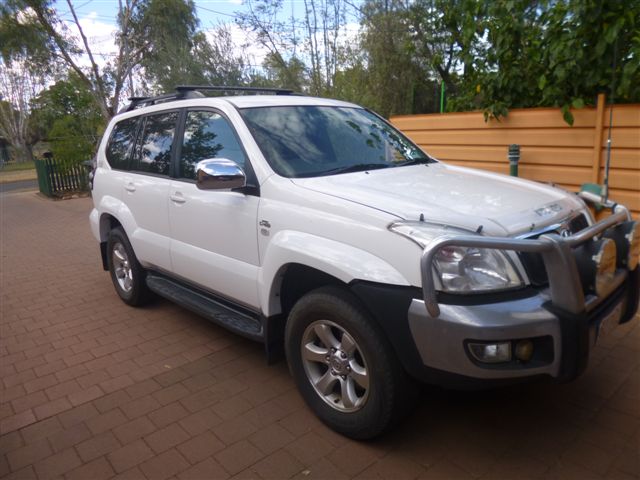

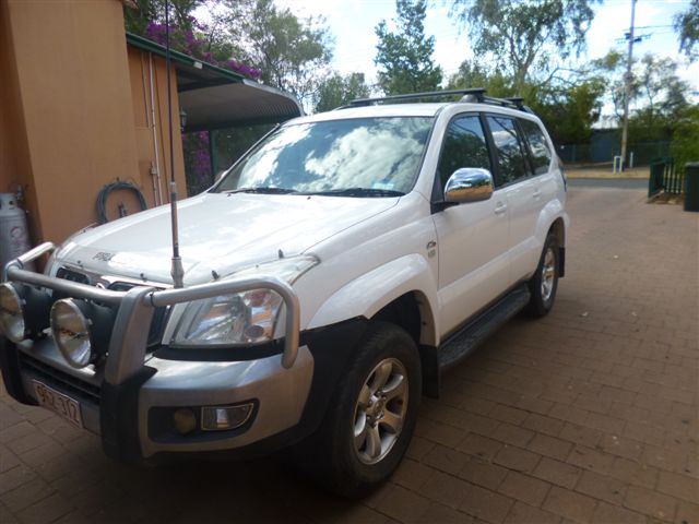

    I picked up my 120 from Alice Springs at the start of the year and drove home to Townsville.
    I was very happy with the way it handled on the trip. I stopped of at the Devils Marbles (hadn't been there for many years)
    Current Build (as purchased)
    * 2007 6 Speed Manual D4D Turbo diesel

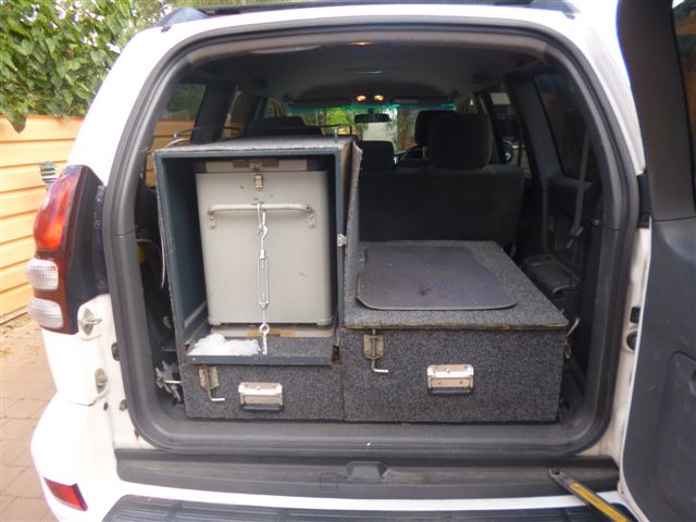

    * Rear draws, Fridge compartment and water tank.Needs some TLC. Has a water tank that sits on right of fridge (not in photo)

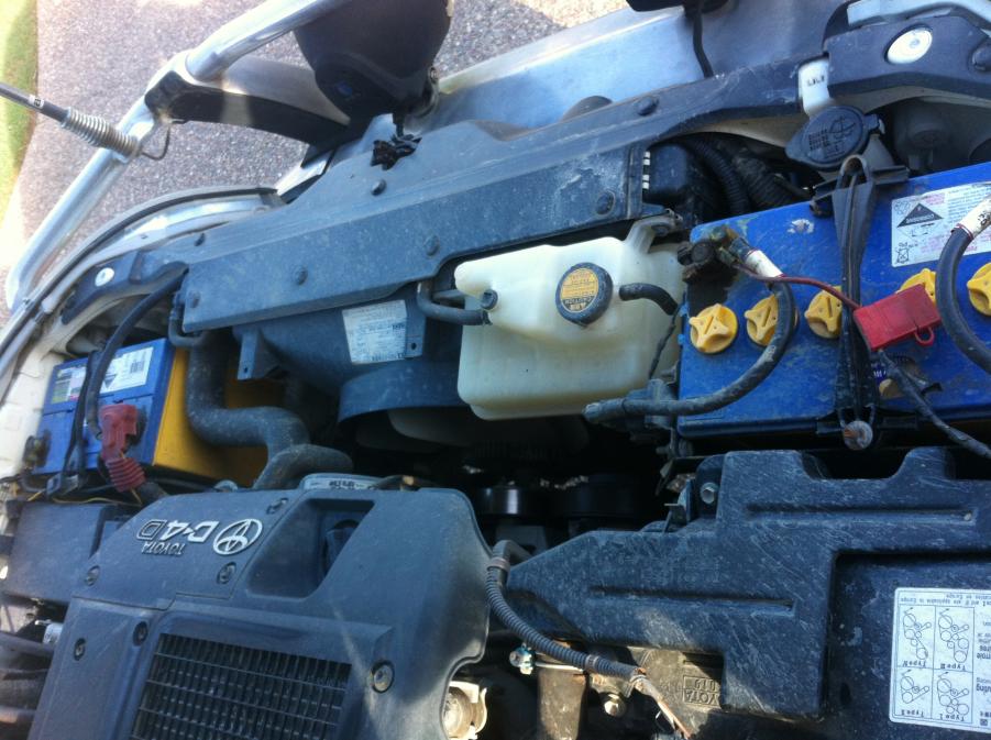

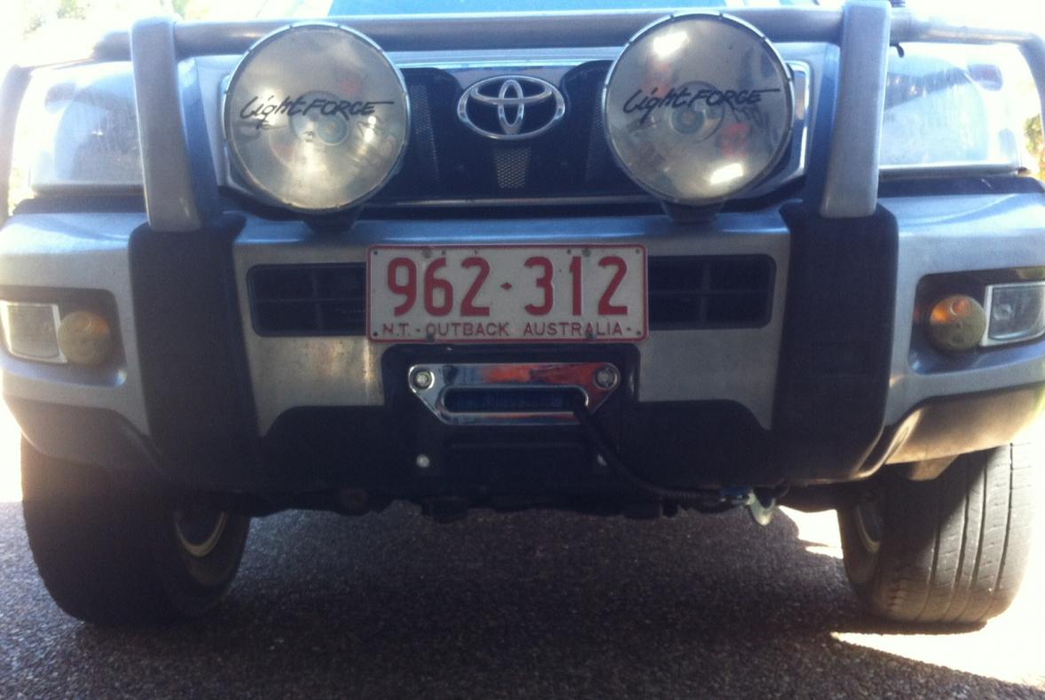

      Well I have just been down to my Toyota dealer and ordered a winch cradle. Should be here on Thursday. I decided to go with Runva EWX9500 with Dyneema Rope instead of the Q variant which is also on order (free delivery)
      Have held of on the Snorkel nearly fell over when TJM quoted there price I guess it will have to stay on the list for now.
      Bit sad when a winch with delivery can cost less than a piece of plastic like a snorkel.
        Well winch arrived today. Still waiting on Toyota for the cradle a week late If it turns up this week I guess I'll be busy on the weekend.
          Well Winch cradle turned up so I decided to put it all on. Why wait for the weekend? I didn't want to disconnect all the wiring from the bar but I also didn't have anything to hold the bar up once I'd unbolted it. After a bit of thought I decided to use a tree in front yard.:idea: (got some looks from the people across the road )
          Anyway pushed the nose of car up to tree strapped it up to the tree and undid all the bolts then I rolled the car back just enough to get the cradle in place, pushed the bar back onto car and did up the bolts. (sounds so easy as I type this). Think I got it all level. Checked gaps around lights and guards. I Should have done this before I started as well now as I look at them I cant remember how much gap was there before (I will check it out next time I see a Prado down the shops)
          Once all that was done I just lifted the winch up into the cradle and did up the four bolts that hold it in place. I haven't hooked up the Solenoid box yet might do that tonight if I can work out were to put it. I also need to get an Offset Hawse Fairlead. Heading up to Wallaman Falls on Saturday so I might be able to give it a bit of a test.

            Fitted the Fairlead for the winch. One job of the to do list
            Fitted the solenoid box in behind bar so I can get to it without opening the bonnet

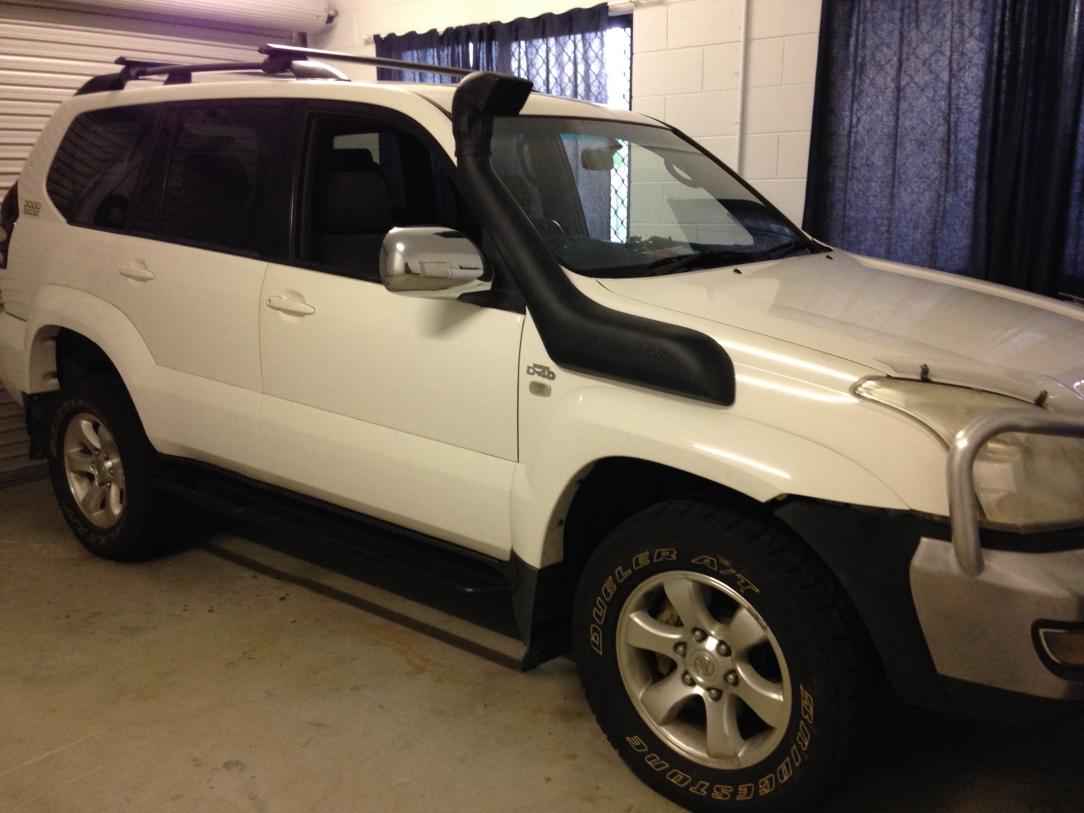

                    Well I got a snorkel from the big guy in the red and white suit. Ill get it fitted when I get a chance.

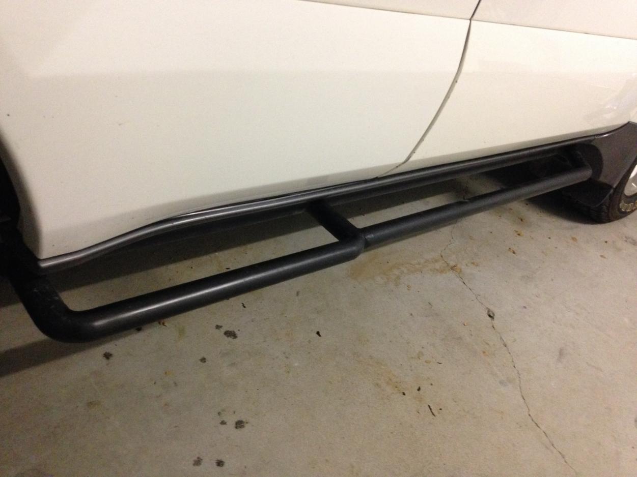

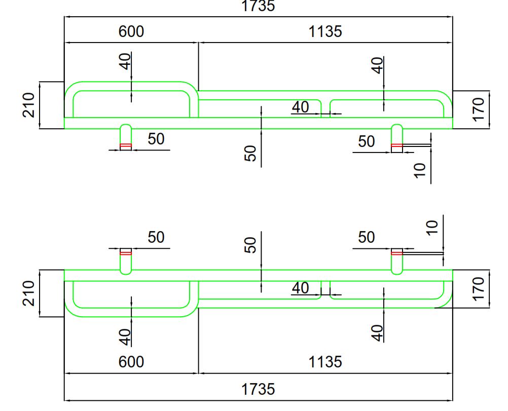

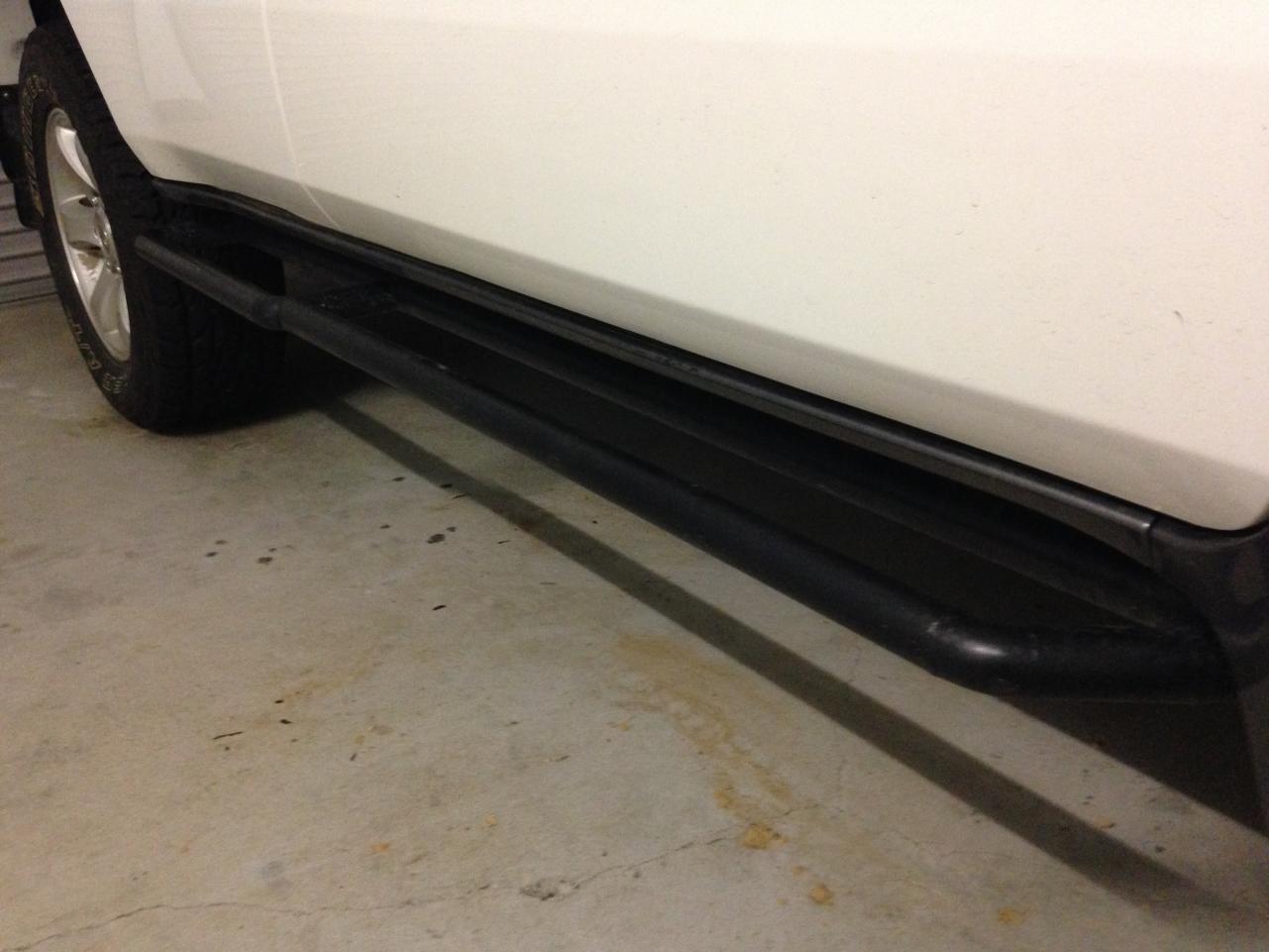

                    I'm in the process of making some rock sliders, heaps of threads full of good stuff stirred me up.
                    Ive drawn up a plans Click image for larger version
                    I'll post some pics once there finished before and after the install. Hopefully they don't take to long.
                    Here are some pics with them fitted to car. I want some checker plate to fit into the gaps

                      Snorkel fitted. Haven't had a chance to test it yet.
