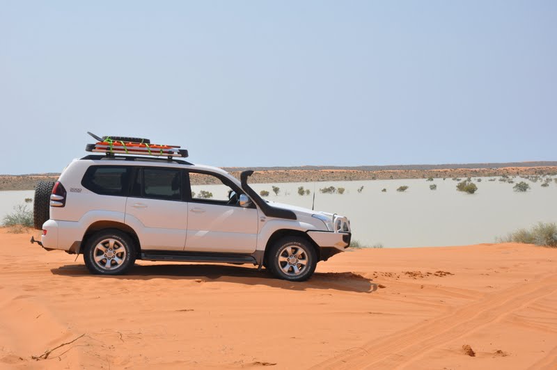

            Heres the maxtrax mounted up on my sportz racks. You could always get a cheap cage and put your spare and anything else (fuel etc) up top along with it...

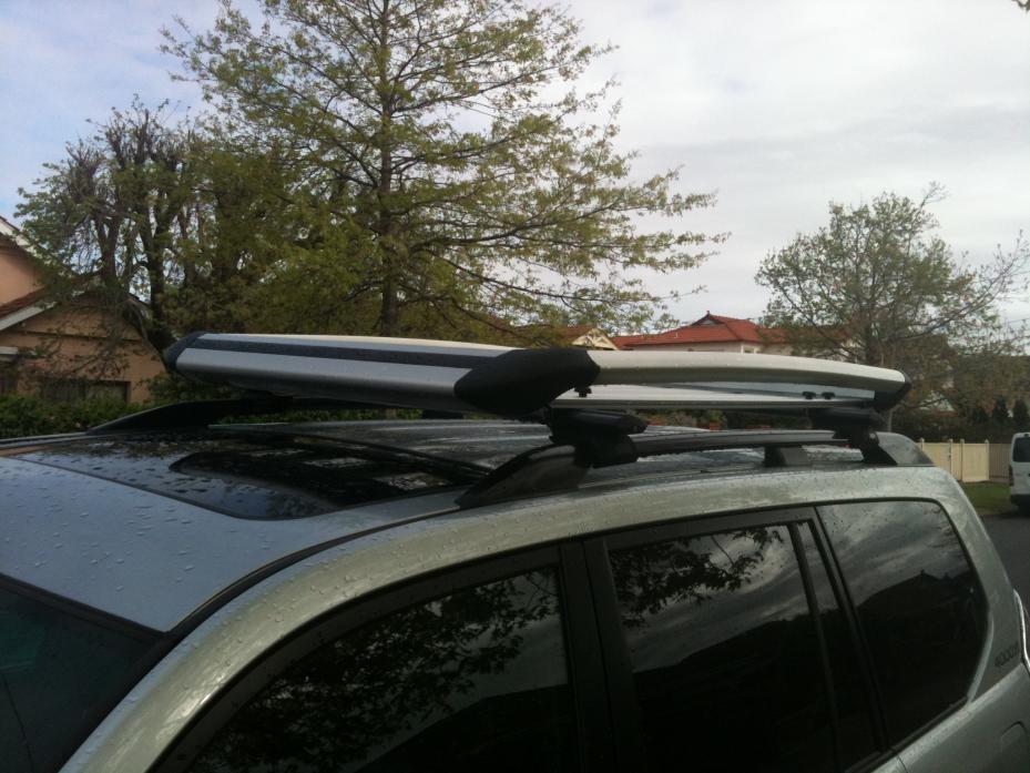

                    How about this....Click image for larger version
                    Nowhere near solid as the Rhino setup but for the things you plan to put-in
                    it's more than enough and cost only $225. Best of all you can take it off in minutes without any help or tools.
