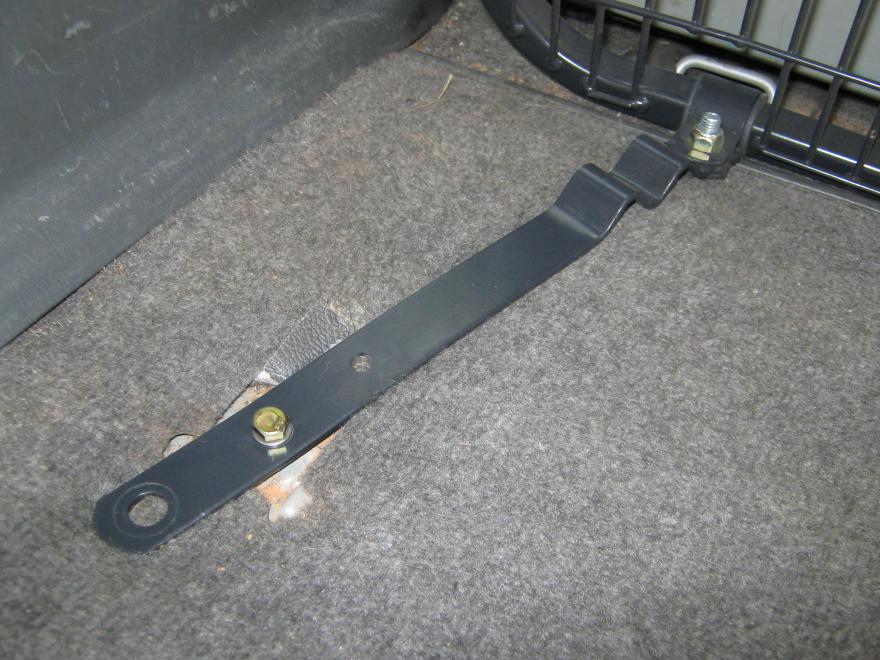

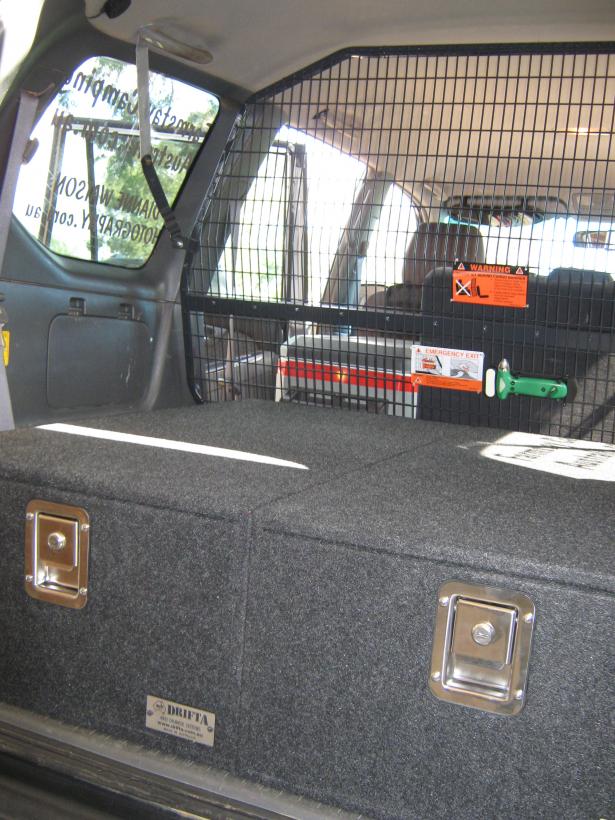

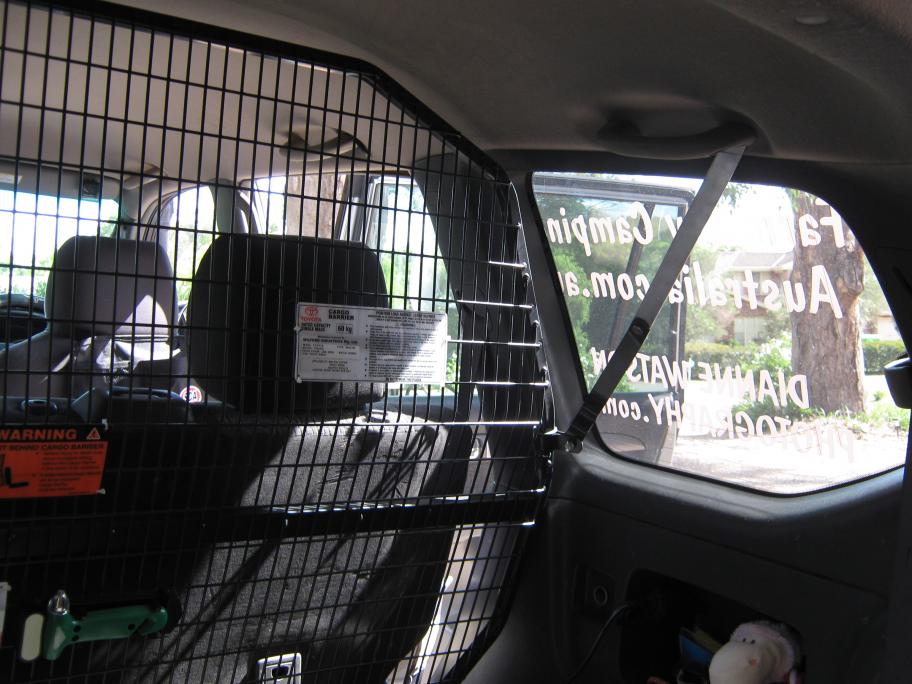

                  Hi all,
                  After experiencing similar issue of ARB quoting for fitting kit of betwen $100 & $140 (for 4 peices of steel and a dozen bolts..... bloody rip off!!!), so I decided to design my own install.
                  Here's what I did:
                  1. Mounted the Floor brackets to the tie down point (measured and drilled new holes to align and used high tensile bolt to attach to floor)
                  2. After looking at multiple mounting points, I decided to mount to the to the rear top grab handles location, using self made brackets from flat steel and again attaching with high tensile bolt.
                  All up the install took 50mins (including making the top rear brackets), and less than $10 on materials (high tensile bolts and flat steel)
