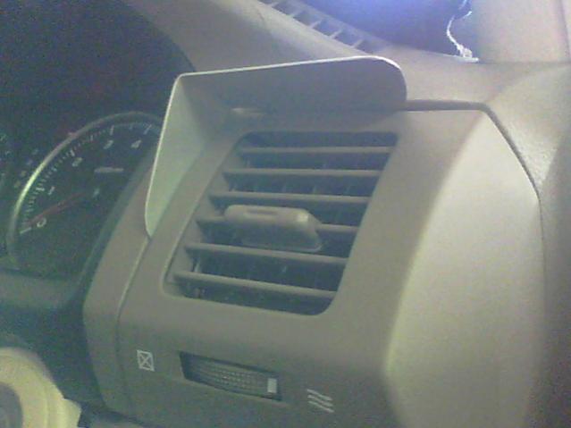

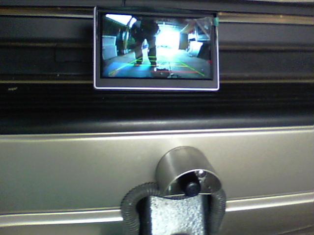

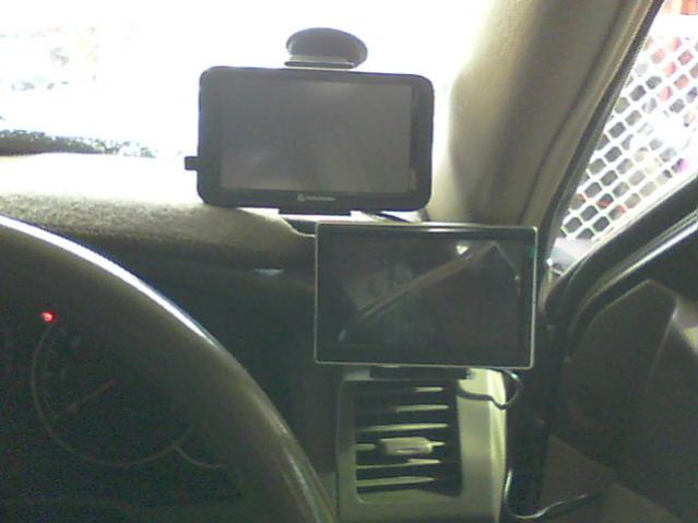

    I got one of those 5" revering camera/screens that Repco recently had on sale for $79. Not a bad unit but not that easy to mount screen and camera so they wouldnt be in the way. Old camera had a 2.5" screen that just clipped onto centre air vent but this one was a challenge to fit.

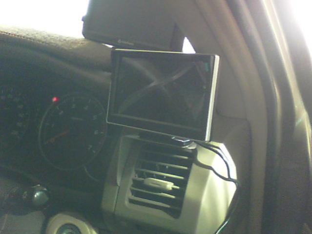

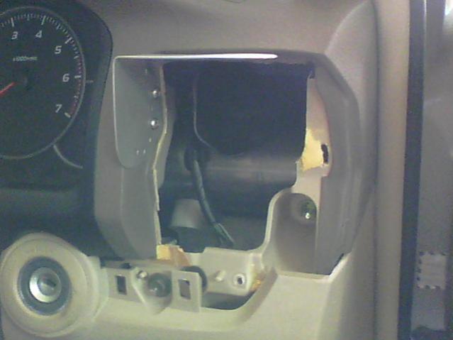

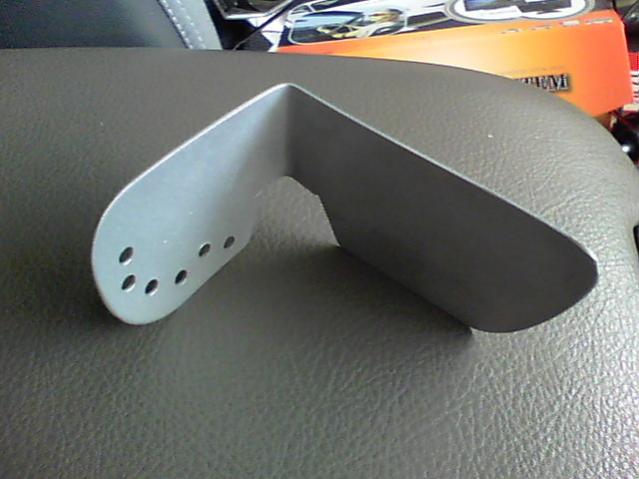

    Eventually worked out best spot would be above the air vent next to drivers door so pulled out vent and made a bracket to screw into dash behind vent so no screws could be seen.

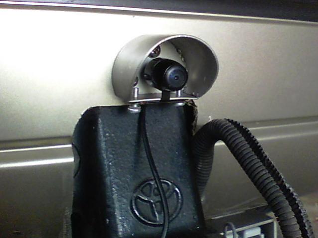

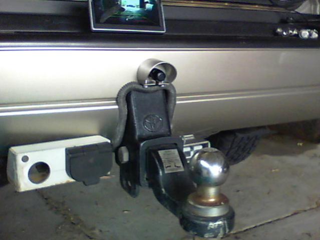

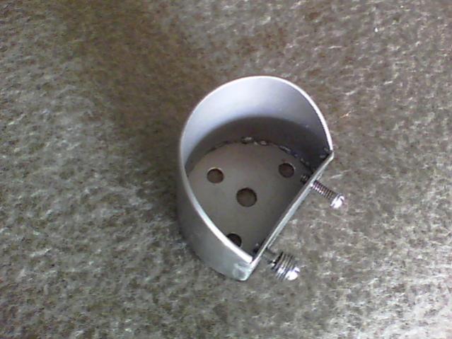

    For the camera made a bracket out of a bit of 40mm stainless tube so camera would be protected and screwed this to bumper above the towbar.

      Cheers. Dash is a bit different but pretty much exactly where we are thinking of putting it.
