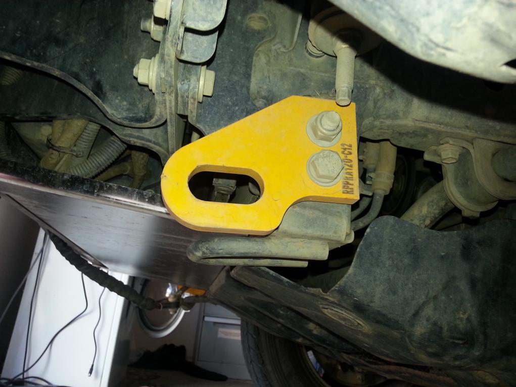

    I have a 120 series 2005 with genuine alloy bullbar. How do I fit recovery points to the chassis as the bullbar takes up some of the holes that the recovery points want to go in? I don't have the skills to be welding spacers etc, just wondering if there is an easier way.
    There is a lot of talk about them here on pradopoint.just do a quick search in google.
    You can buy these and they are an easy fit . you just have to remove the bottom bolts on the radiator to fit them.
    I remember someone on here selling them ?
      Bolt on are available but you need a spacer for the other bolt to compensate for the gap. Posts 69 and 70
