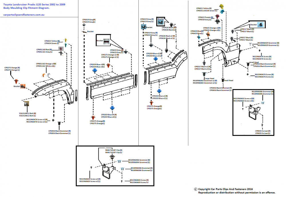

    Hi all, am replacing my rear left flare and have purchased a set of clips online - they are colour coded, but instructions didn't come with it - anyone know where I can find a copy please?

    You will see the colours when you remove the old flare. There will be Grey / Blue and Orange clips. you will also need to double sided trim tape/piece that goes between the flare and the body.
    The clip holders often break off the flares and door moulds. be careful removing them. A lot end up using a strong Mastic to hold the clip brackets in place.
    You can also go onto Partsouq or amayama and find the part numbers, then google them to see what colour they are.
      Thanks Piggy, old clips were long gone - I emailed the clip supplier and he sent me the attached.

        Wow - thanks for the diagram andwhich also gave the supplier. I too am replacing my LH rear flare and only 1 clip to hand - the clip guy in Coiffs wanted to know the colours too, but just bought mine from Car Parts clips and fasteners
          Thanks for sharing , very useful , my rear passenger guard fell off and not all the original clips where there, so it was difficult to know which colour went where.
