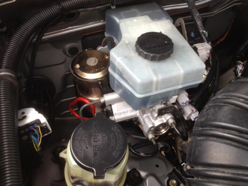

                You don't need to start the car just turn the ignition on, you should hear the electric pump start which pressurises the accumulator. I have included a picture of the accumulator style of brake booster below. Assuming yours is the same as the Australian VX model you should defiantly have this style of brake system. I have bled mine several times and never had any problems.
