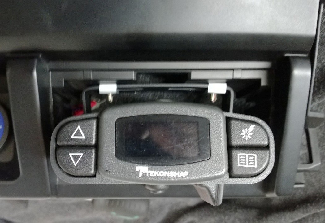

                Great idea from matthew to mount in ashtray, i found though that it was a bit low for me (6') so i altered the mounting slightly to be able to be better viewed and access to the bottom lever.
                (Apologies for quality, taken at night with old point & shoot)
                Hope its clear what i did. it enables me to take it out when not in use (approx 90% of the time unfortunately )

                        Another ashtray install variation.
                        Finally got around to moving the P3 from beside the steering wheel. Remove the ashtray and surround, drill a couple of holes into the plastic frame, add some speed nuts and you're done. Simple and effective, can go back to factory ashtray in 20 minutes with no sign of being there and best of all no more knee banging.
