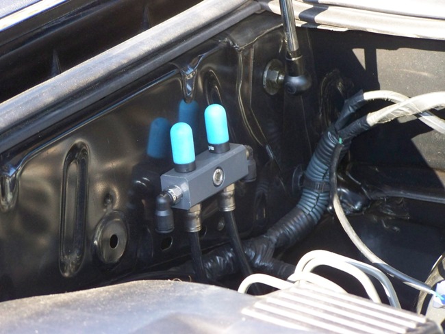

                          • #73
                            Re: Diff Breathers
                            Hi Matt
                            I bought a kit off eBay that did the 2 diffs, transfer case and auto, however when I got to the transmission, I found that the one breather did both via a T join. I simply removed the breather hose from the T joint and connected the new hose supplied with the kit and chased it up to the breather manifold (came with the kit) in the engine bay. The only thing I will say is that there is very limited room to place your hand up (right side of transmission) but it can be done without a hoist.
                            I will take photos on weekend, but here is a shot of the mainfold unit.
                            [attachment=0:kc1adx1i]DB Manifold.JPG[/attachment:kc1adx1i]
                            Black 2003, TD, GXL Prado

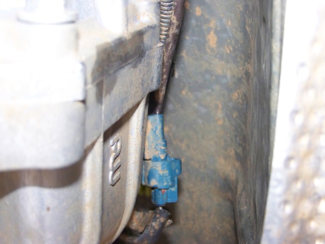

                                Re: Diff Breathers
                                Originally posted by pradogxlv6
                                Awaiting your pix !!
                                Matt,
                                This is the best I could do.
                                Ist pic shows the location to find the Y joint (I know I called it a T before, it's actually a Y). It is where the transfer case joins the transmission on the driver's side (you can see the exhaust shield). Reach on top of this area on the right hand side and you will feel it. If you pull it slightly to the right you will see the 3 hoses and metal Y joint.

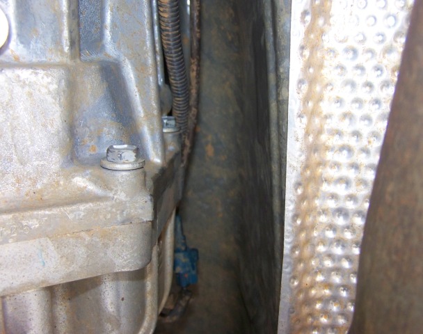

                                The next pic shows exactly where to find the Y joint, it is just on top of the blue electrical plug. Now I have assumed the petrol is the same as the diesel, because I can't see why it would be different.
                                [attachment=0:bycb2463]tranny3.JPG[/attachment:bycb2463]
                                Hope this helps, if not let me know what else you need. Only too happy to help.
                                Andy
