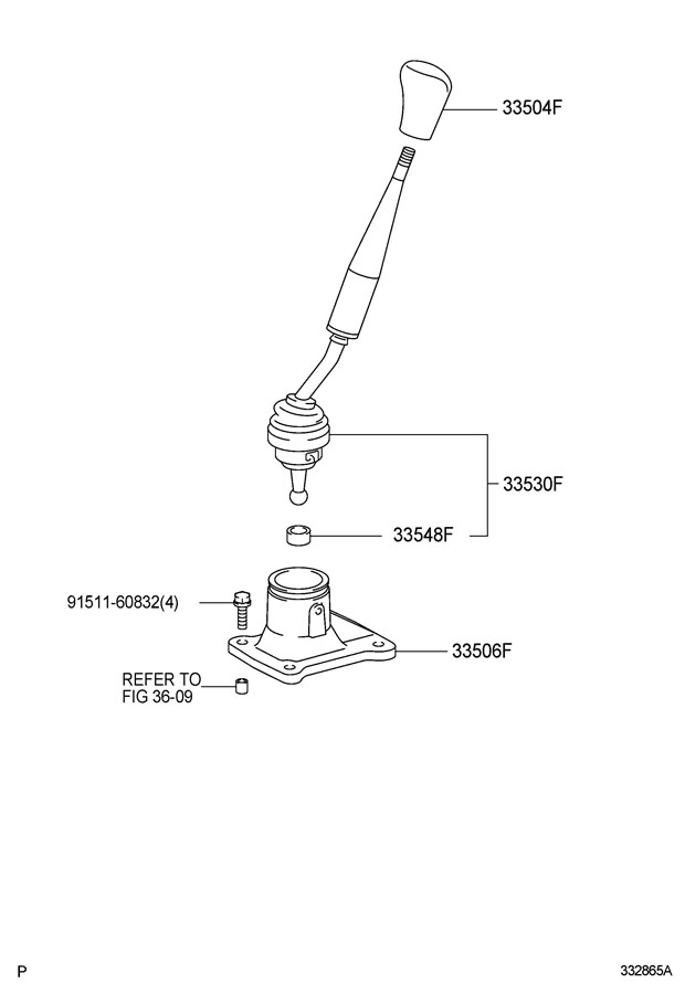

                        Good info.
                        I found a diagram for the parts in question
                          Nice, very nice...
                          Winston.
