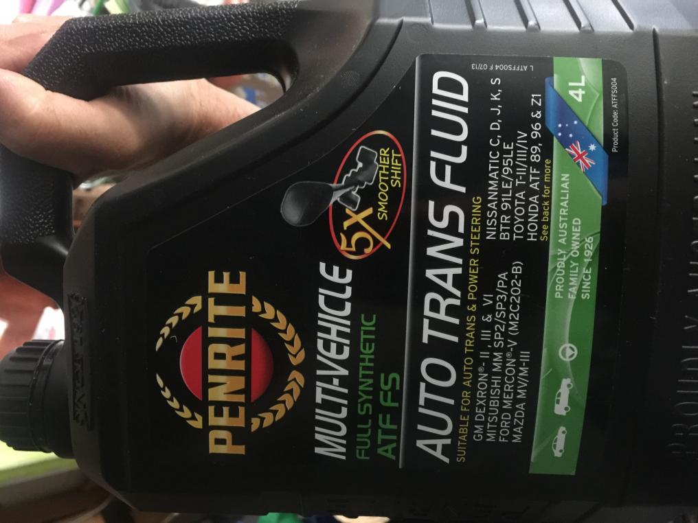

          03 120 so 4 speed. Thinking of just doing a sump oil drain and change in it for now and doing filter next time.
          Can I just use this? Will it mix okay with whatever is already in there?

            Perfect. All you need to do is change the oil.
            Drop out the 3-4 ltrs every 20,000k & see how good it is after a few of those
