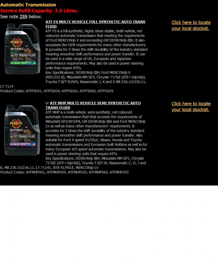

                            Can anyone point me in the right direction in relation to the oil for the 4 speed auto in a 2003 Grande V6?
                            I have had a look at the Penrite site (based on ####'s information above) and it comes up with two different types (a Full Synthetic and a Semi Synthetic) - info in picture.
                            Also, it has a note (259) which states the following: Models from August 2003 (refill plug marked 'WS'), use ATF FS MULTI VEHICLE FULL SYNTHETIC AUTO TRANS FLUID.
                            Still not sure if the 4spd uses the full or semi synthetic and really don't want to make a costly mistake.

                              So all done - ended up using a Nulon full synthetic (Product code ATF4).
                              Being a 4 speed (which has a dipstick) and a V6 (has a transmission cooler) I just disconnected the top cooler line that goes through the radiator support on the passenger side, extended the line to the floor using clear hose as previously mentioned so I could monitor the colour of the fluid and switched the car on to pump fluid into a canister to measure what was drained.
                              I then topped up through the dipstick tube, 2 litres at a time out/in.
                              After 12 litres the fluid had changed colour considerably - went from looking like used motor oil to slightly discoloured when compared to the fresh stuff.
