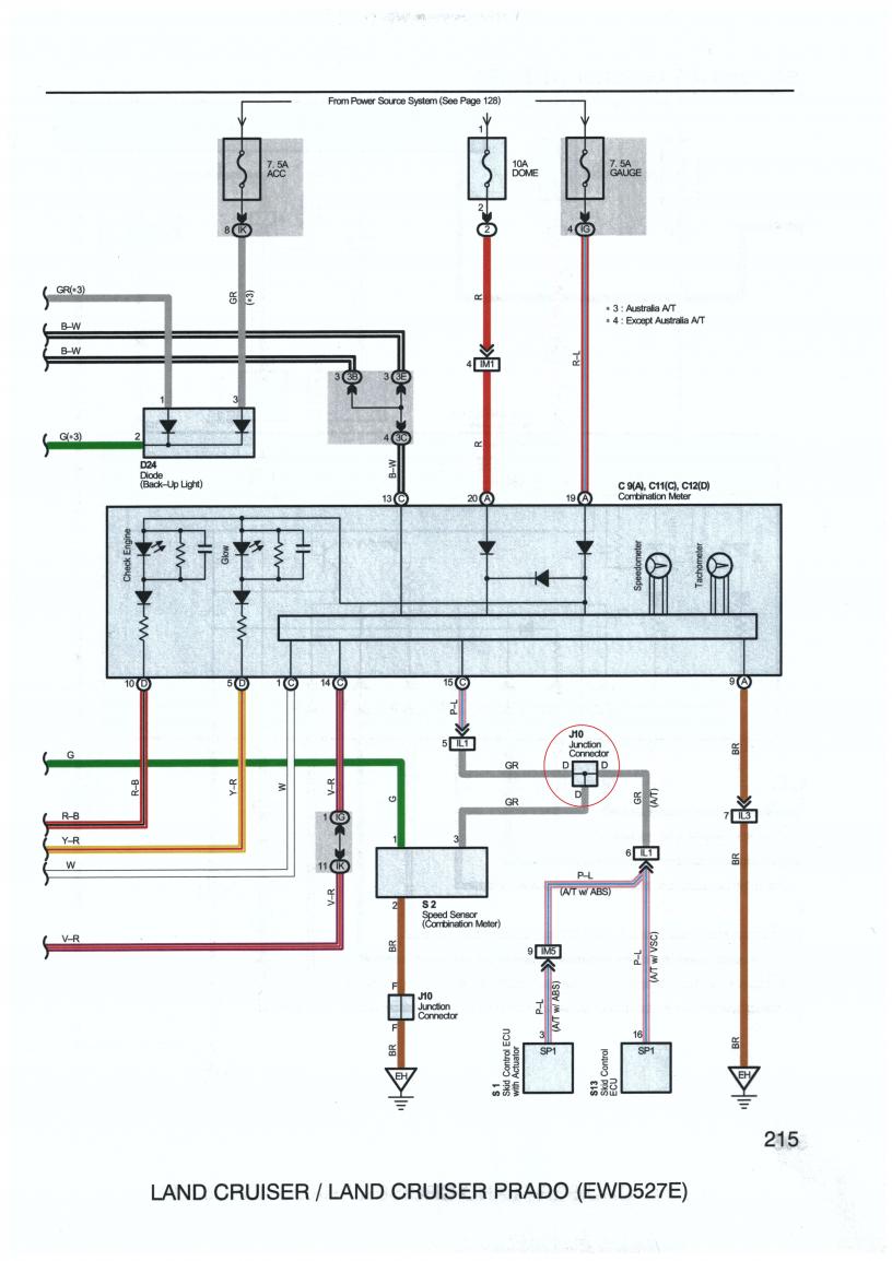

    Peter - The electrical wiring diagram shows J11 Junction Connector from speedo part no 90980-11915 which looks same as the connector in your post above (I have to try and post images of J11 if required). IL1 connector does not seem to appear in the wiring diagrams. I understand YellowBox have the J11 connector info.
    AB

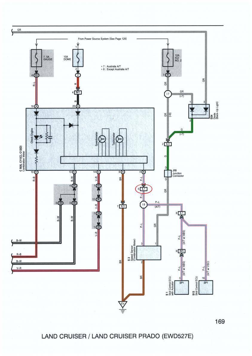

    IL1 does appear in the wiring diagram, just not in the parts list:
Name:	IL1 Pin 5.jpg

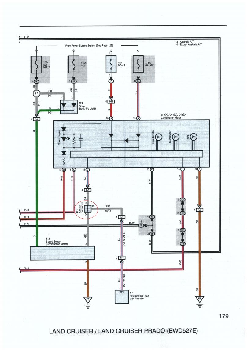

    J11 is here:
    J10 is here:

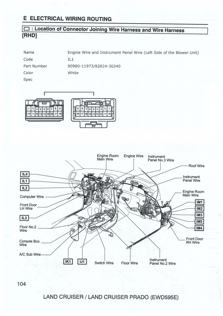

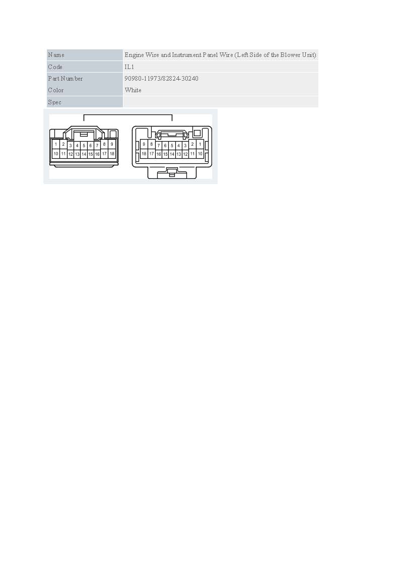

      Apologies. Check manual section under 2005.8 model, connector list. (I think this is connector only - Please check). I have to learn to post images.
      Name Engine Wire and Instrument Panel Wire (Left Side of the Blower Unit)
      Code IL1
      Part Number 90980-11973/82824-30240
      Color White
Name:	Prado Connector IL1.jpg
      I have emailed this to Yellow Box.
      This seems same as connector N4 - Same first part number.
      AB

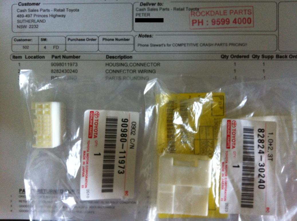

            I have ordered a set of IL1 connectors from Toyota for $23.30 with the view to making an IL1 harness.
            Part Numbers 90980-11973 and 82824-30240
Name:	IL1 Connector Locator with Part Numbers.jpg
ID:	640728 Click image for larger version
ID:	640729 Click image for larger version
ID:	640730 Click image for larger version

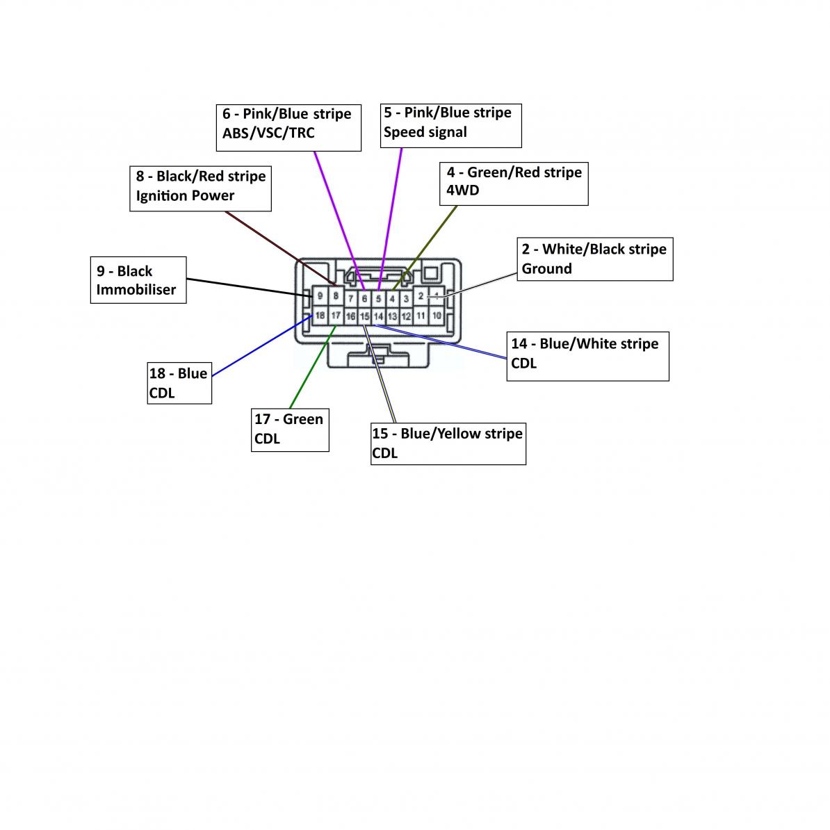

            Only 10 out of the 18 wires to these connectors are utilised on my particular model:
            Pin 2 - White with black stripe (Ground)
            Pin 4 - Green with red stripe (4WD)
            Pin 5 - Pink with blue stripe (Speed Sensor)
            Pin 6 - Pink with blue stripe (ABS/VSC/TRC)
            Pin 8 - Black with red stripe (Ignition Switch Power)
            Pin 9 - Black (Immobiliser)
            Pin14- Blue with white stripe (Center Diff Lock)
            Pin15- Blue with yellow stripe (Center Diff Lock)
            Pin17- Green (Center Diff Lock)
            Pin18- Blue (Center Diff Lock)
            As confirmed by busha and the OP in this thread, the 3 wires in the IL1 connector of interest are:
            Pin 2 - White with black stripe for the earth connection
            Pin 5 - Pink with blue stripe for the speed signal
            Pin 8 - Black with red stripe for power source
            Hopefully I'll be able to make up a harness for my vehicle and avoid having to cut and splice wires.
              Well, I got the IL1 connectors from Toyota and what a woftam that exercise was. The connectors not only don't have wires, they don't even have pins installed:
              These are useless and I'll be sending them back to Toyota. It seems the only solution is to cut and splice the existing wiring to install a speedo corrector, just like busha has done.
                Well, Stewart Toyota Rockdale Parts have refused to refund or even to credit me the paltry $23.30 that I paid for the IL1 connectors. Apparently Toyota don't refund "special orders". Buyer beware

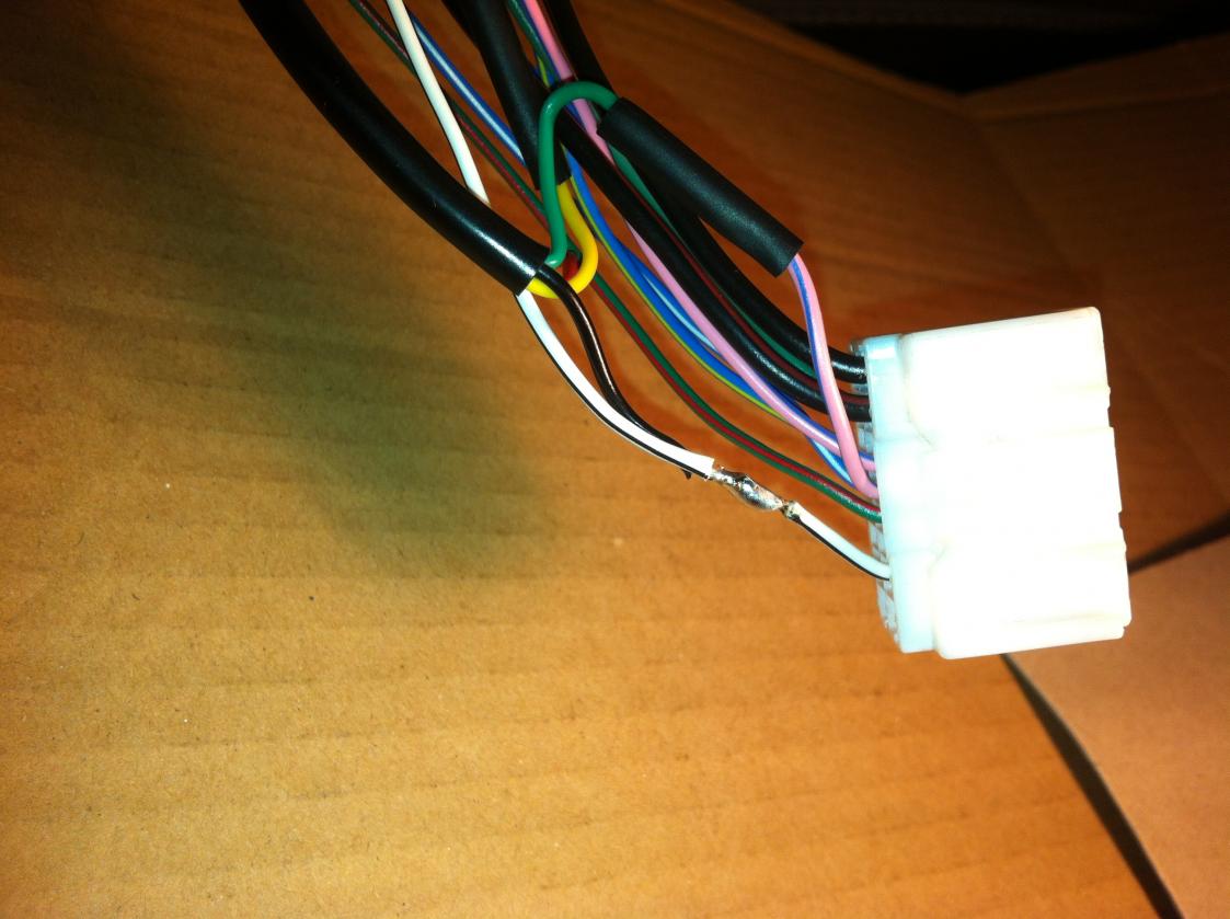

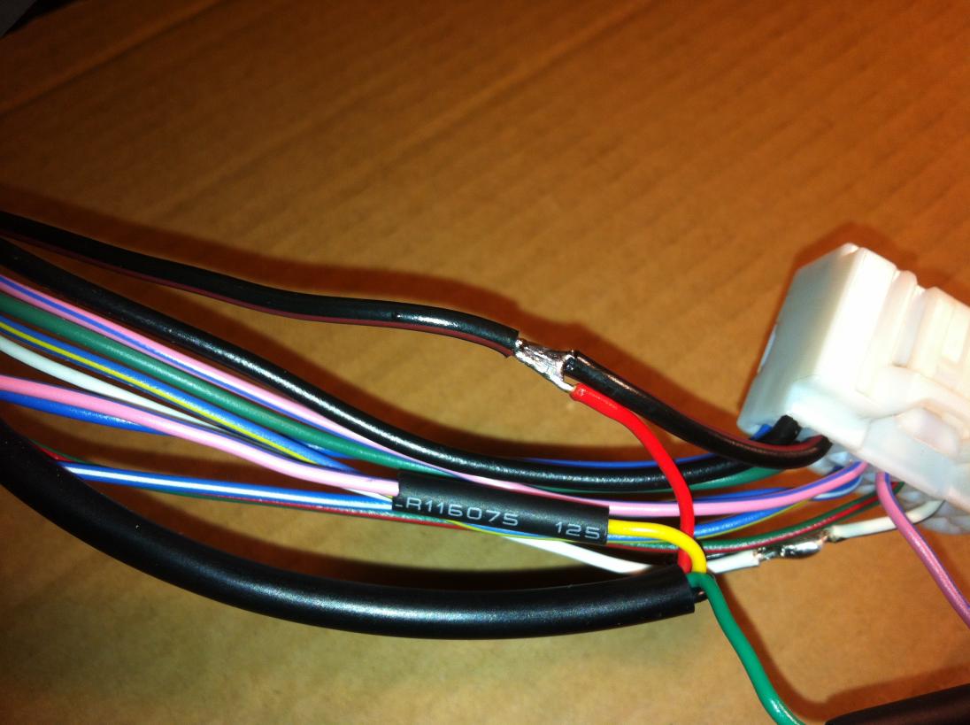

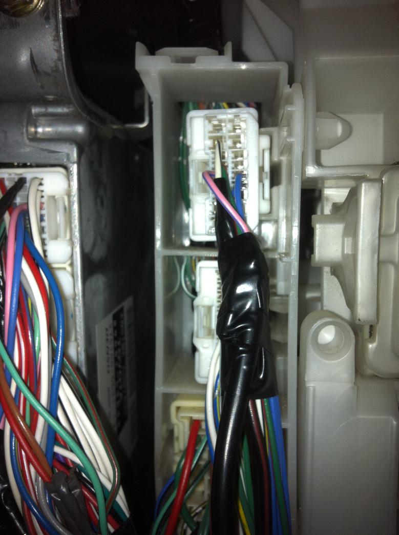

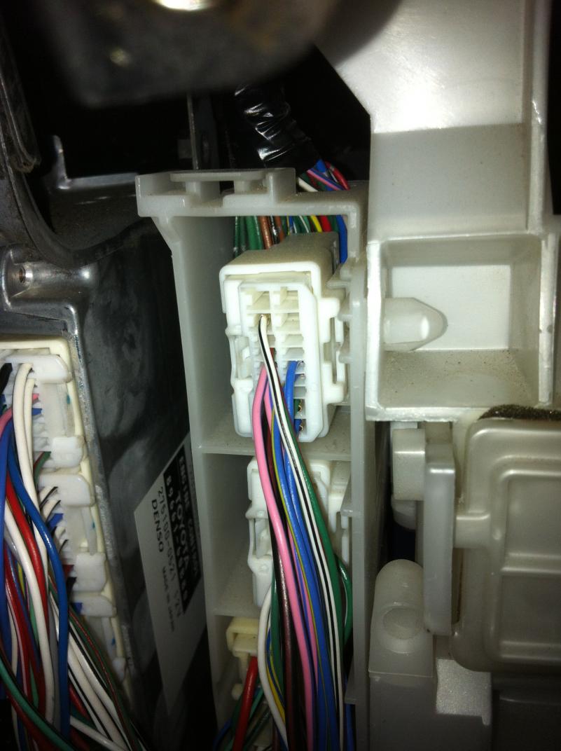

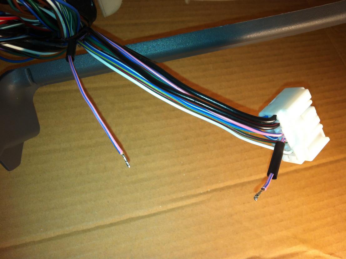

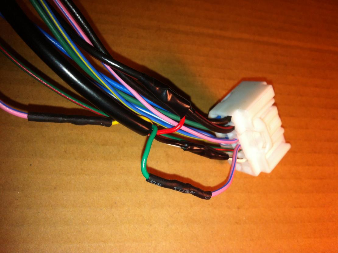

                    Pictures of my Yellow Box installation.
Name:	IL1 Connector with Wiring Labels.jpg
ID:	640954 Click image for larger version
Name:	IL1 before.jpg
ID:	640955 Click image for larger version
Name:	Back of plug.jpg
ID:	640956 Click image for larger version
Name:	Pin 5 wire cut.jpg
ID:	640957 Click image for larger version
Name:	Pin 5 soldered.jpg

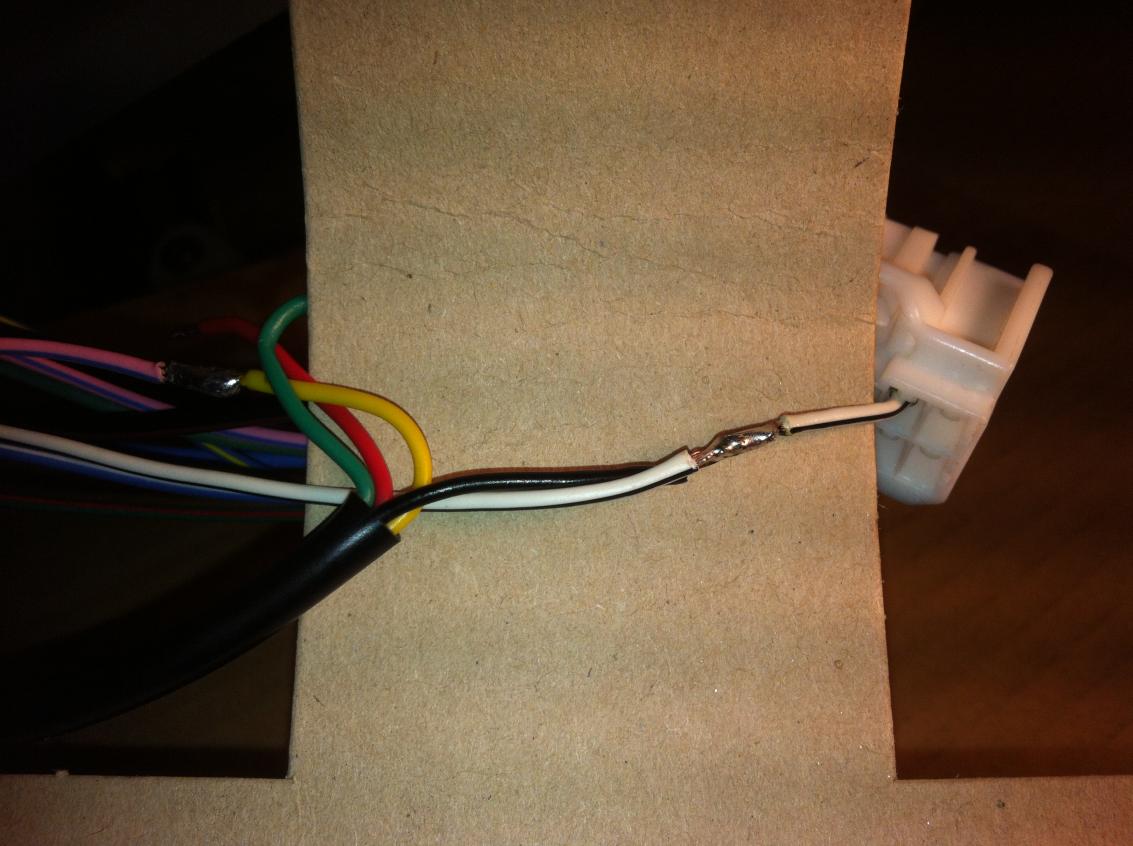

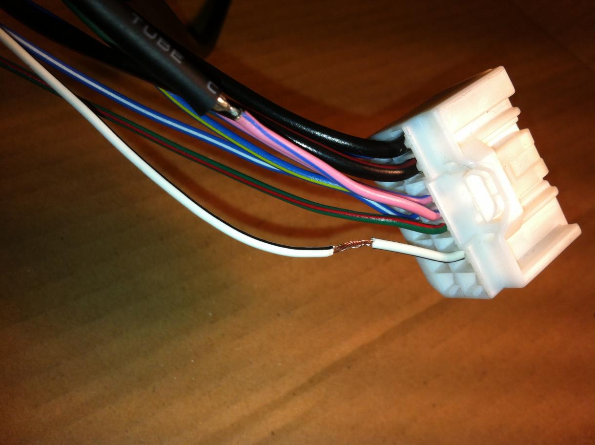

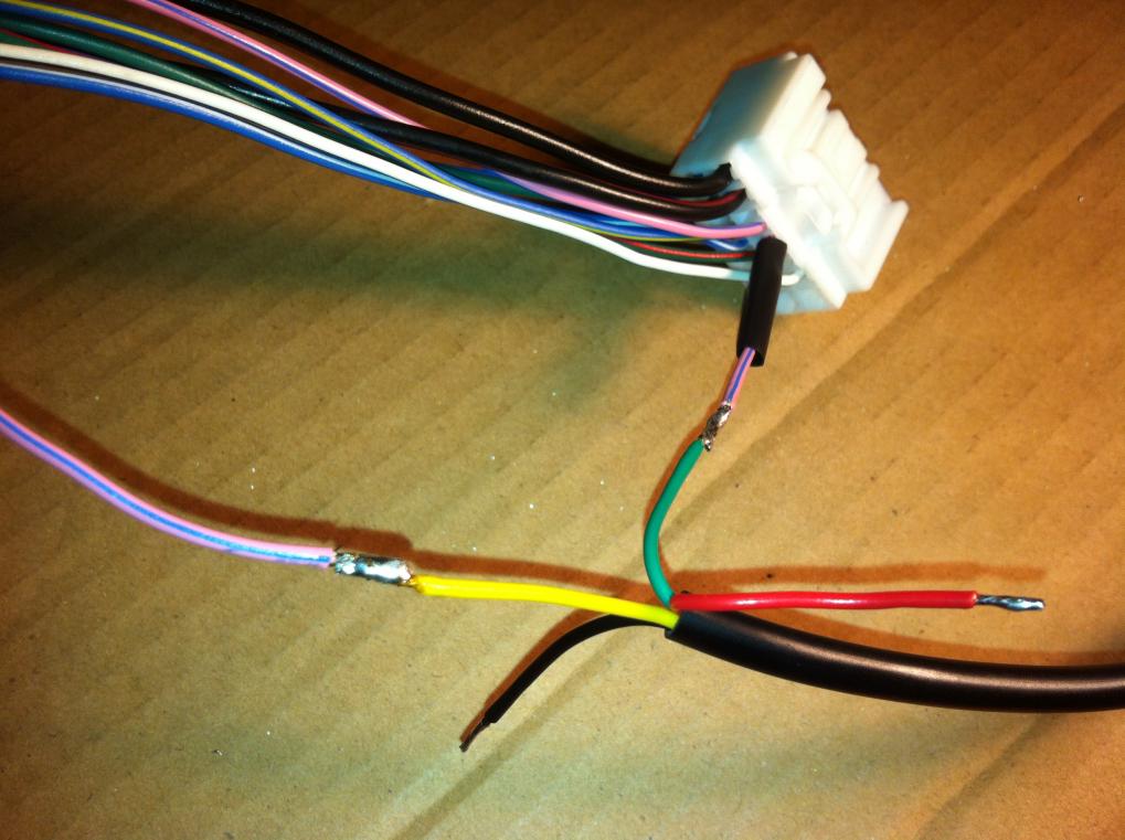

                      Pictures of Yellow Box installation part 2:
Name:	Pin 2 spliced.jpg
ID:	640959 Click image for larger version
Name:	Pin 2 soldered.jpg
ID:	640961 Click image for larger version
Name:	Cardboard heat shield.jpg
ID:	640960 Click image for larger version
Name:	Pin 8 soldered.jpg
ID:	640962 Click image for larger version
Name:	Before insulation.jpg

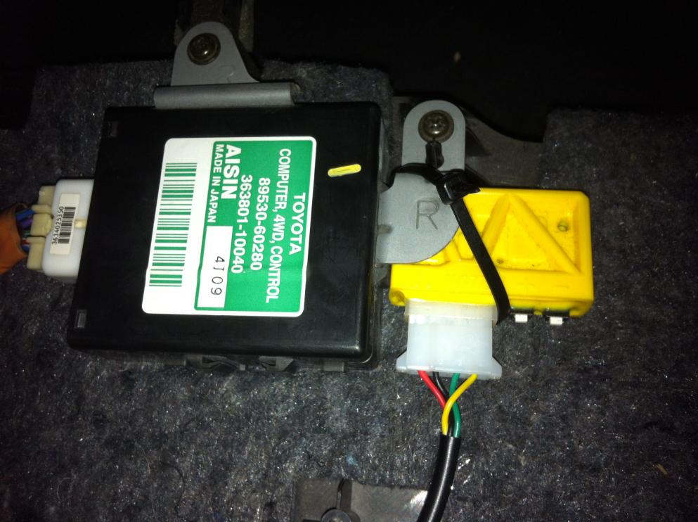

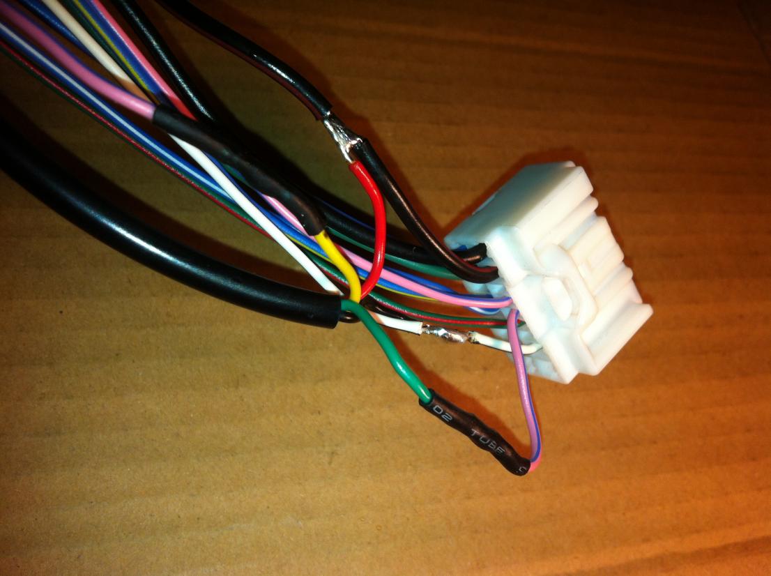

                        Pictures of Yellow Box installation part 3:
Name:	Wires insulated.jpg
ID:	640964 Click image for larger version
Name:	Wrapped & plugged.jpg
ID:	640965 Click image for larger version
Name:	YB and 4WD ECU Secured.jpg
ID:	640966 Click image for larger version
Name:	Yellow Box V5-1.jpg
ID:	640967 Click image for larger version
Name:	Yellow Box V5-2.jpg

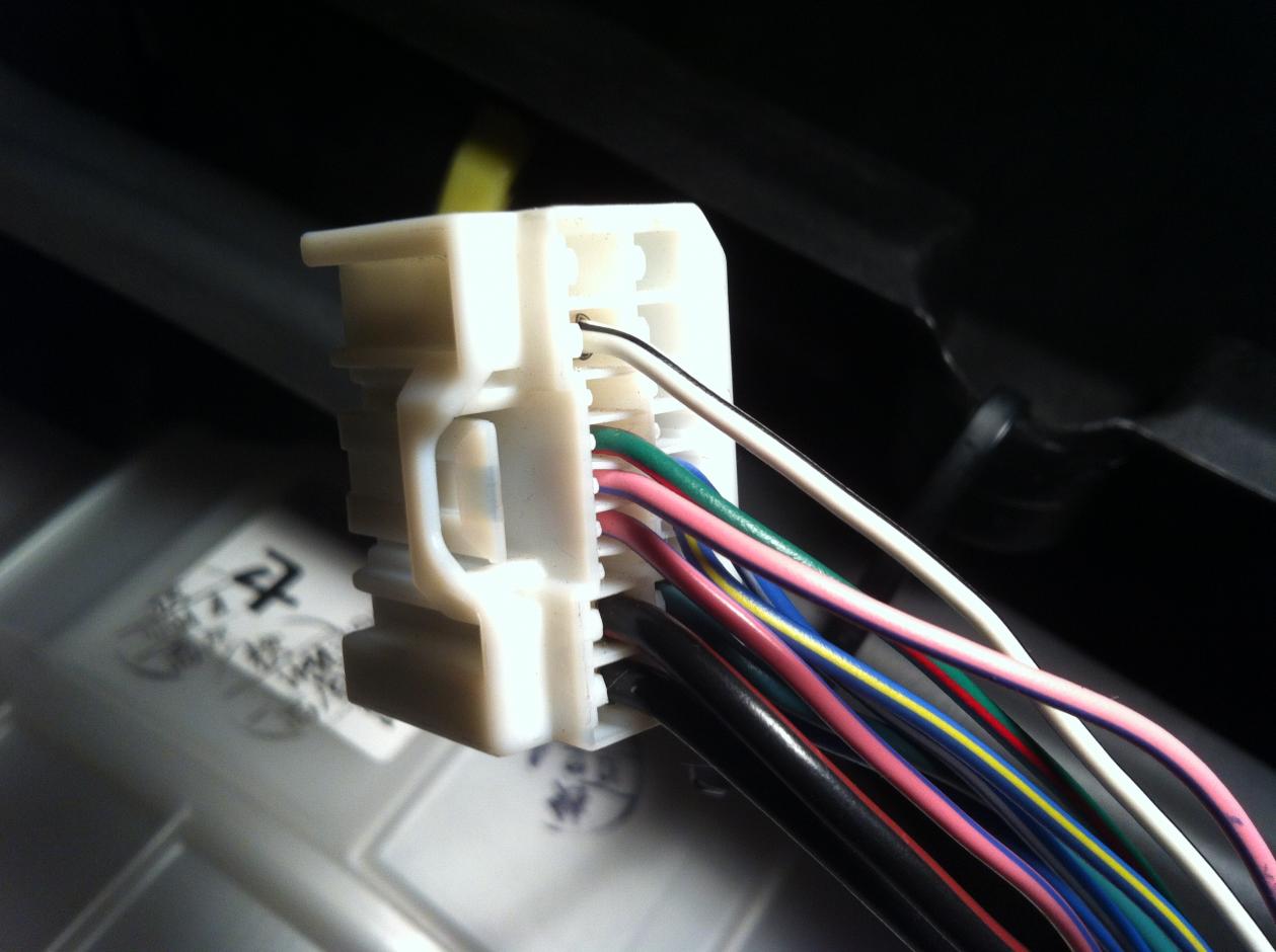

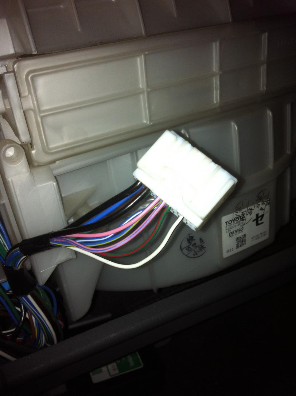

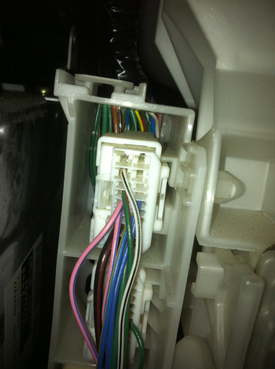

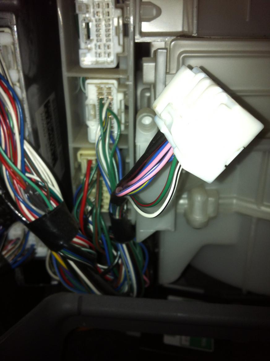

                          Wiring issue with instalation
                          Hello Everyone,
                          I was hoping someone on here may be able to assist me with their greater knowledge. I have bought the yellow box and went to install is as per instructions on here. Unfortunatly my wires are different coloursfor some reason??? My prado is 2005 KZJ120 Grande.
                          Any thoughts/help would be greatly appriciated. I will post some photos of wiring soon.
                          Troy
                          2005 Toyota Prado Grande 3.0 TD - ARB Deluxe winch bar, Avenger 9500lb winch - nylon rope, Safari Snorkel, DP Diesel Chip, Lightforce HID 240's 50w, Oricom UHF, Bushranger Mud Tamer mats, Toyota Genuine Tow Bar, Toyota Genuine bonnet protector and headlight protectors, ARB Roof top tent and awning, ARB dual battery system with Red ARC and Optima deep cycle battery, Max Trax, ARB Compressor and Rear Air Locker, Waeco 50L fridge/freezer.
                          • #28
                            Originally posted by Troy1 View Post
                            Hello Everyone,
                            Troy
                            http://i1311.photobucket.com/albums/...s93cc54a2.jpeg
                            http://i1311.photobucket.com/albums/...sdb30b841.jpeg
                            http://i1311.photobucket.com/albums/...sa334d0d2.jpeg
                            • #29
                              You need to reference the wiring diagram for the 1KZ motor. What colour are the wires that go to pins 2, 5 & 8?
                              • #30
                                Looks like pin 2 is white with black stripe - this one is your earth wire. I can't make out the colour of the wires to pins 5 & 8 from those photos.
                                On my wiring diagram, pin 5 is grey for the 1KZ - this is the speed sensor. Pin 8 should be black with red stripe - this is the power source.
