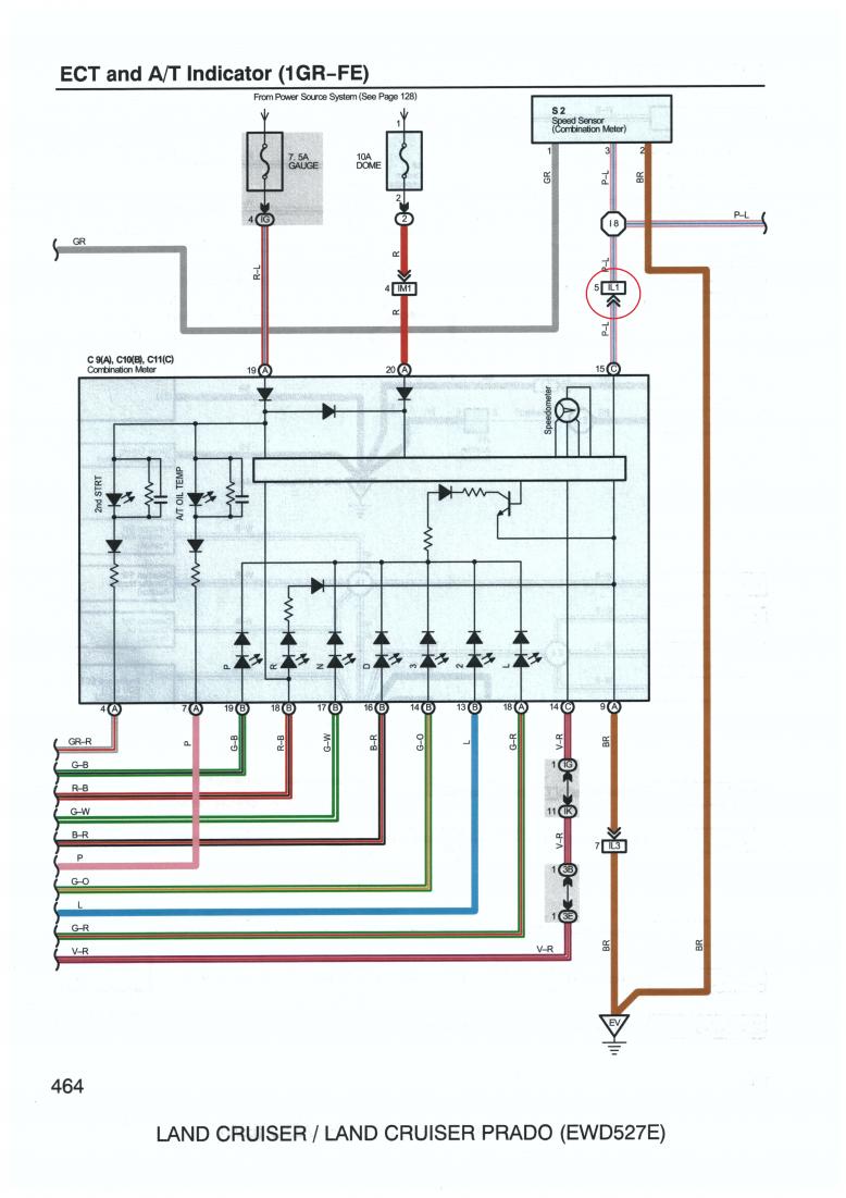

        IL1 Pin 5 1GR-FE model pink with blue stripe speed sensor wire:
Name:	IL1 Pin 5 1GR-FE.jpg

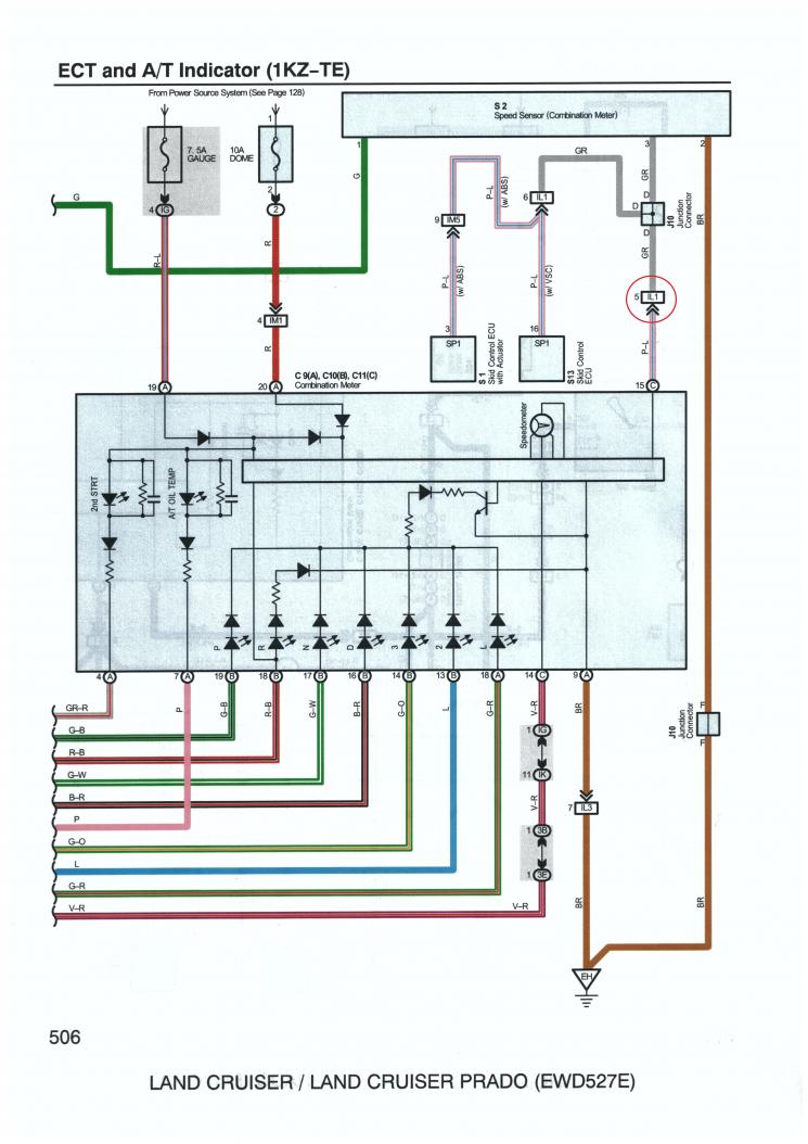

        IL1 Pin 5 1KZ-TE model grey speed sensor wire (also applies to the 1KD-FTV model):
Name:	IL1 Pin 5 1KZ-TE.jpg

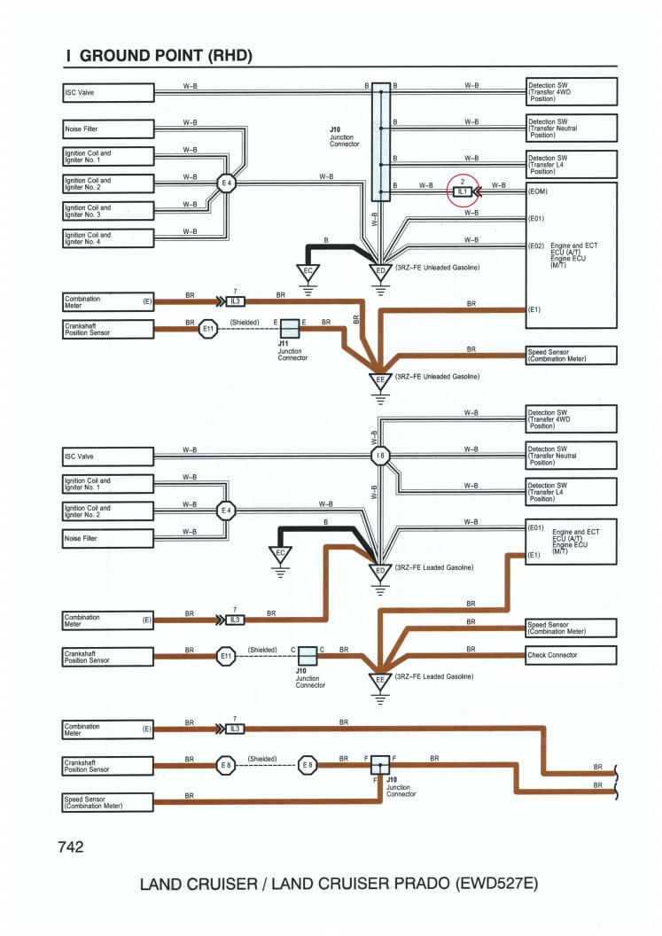

        Pin 2 on the IL1 connector is ground and the wire is black with white stripe on all RHD models:
Name:	IL1 Pin 2 Ground Point.jpg

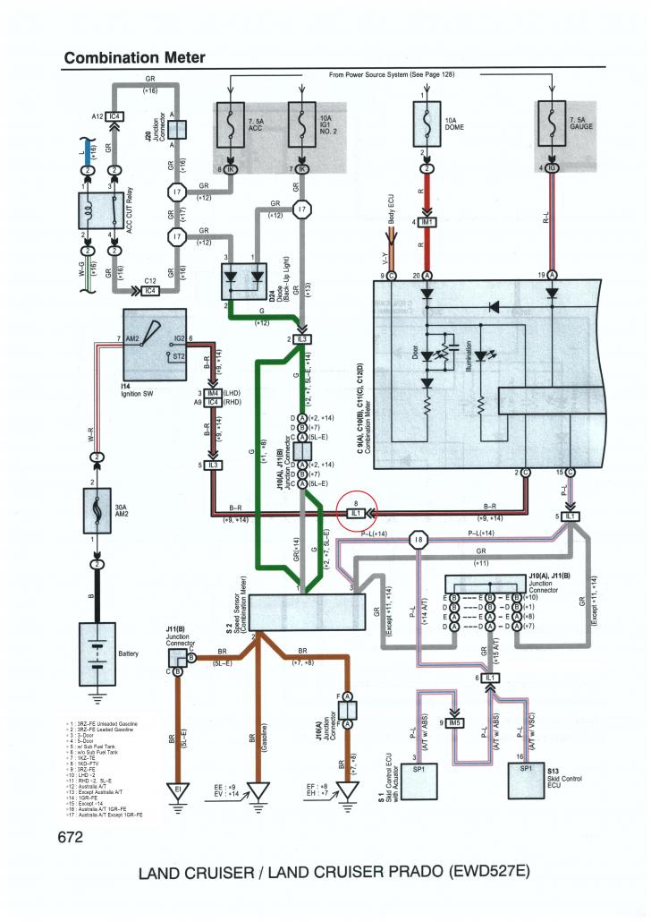

        Pin 8 on the IL1 connector is ignition power and the wire is black with red stripe on the 1GR-FE:
Name:	IL1 Pin 8 Ignition Power.jpg
        The wiring diagram doesn't specifically show a wire on pin 8 for the 1KZ-TE (or the 1KD-FTV). If the wire is not present at pin 8 then an alternative 12V ignition power source will need to be found.
