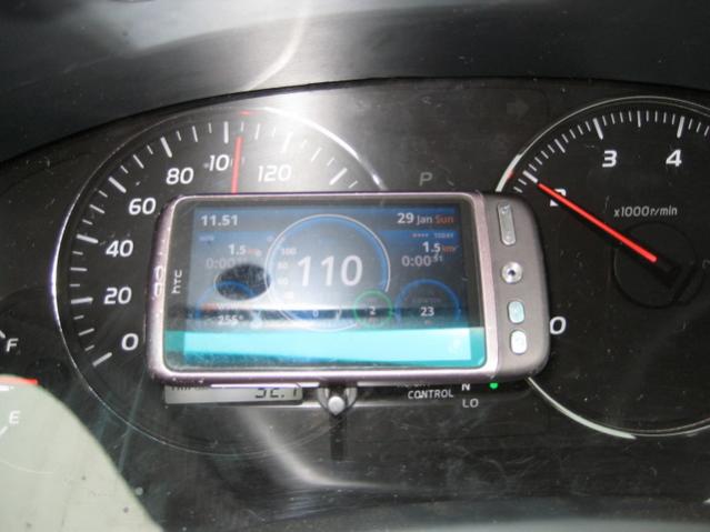

After upgrading the tyres to some nice new Cooper S/T Maxx, I began looking for a way to recalibrate the speedo to compensate for the larger tyre diameter. Like many fellow PradoPointers running 265/70/R17s I found my speedo reading under by around 5%. To my surprise I found most people were happy to tolerate the error, but after my latest impromptu meeting with the kind folk of the WA police force, I decided to get serious about getting it sorted. With the new tyres my speedo was reading 105kph when my true speed was 110kph

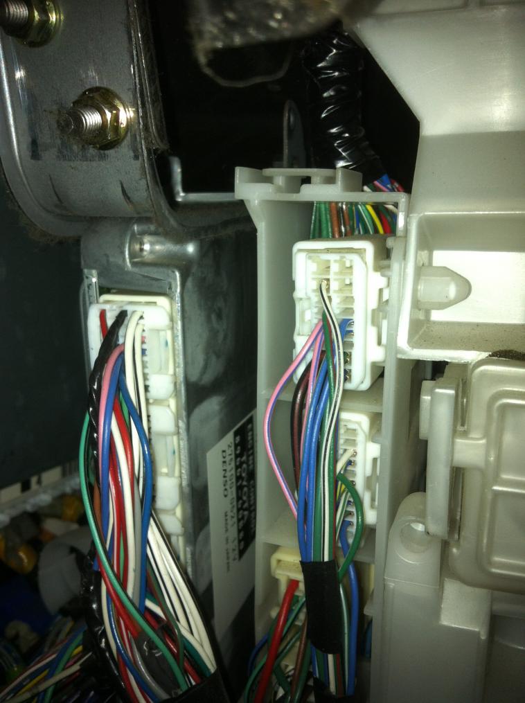

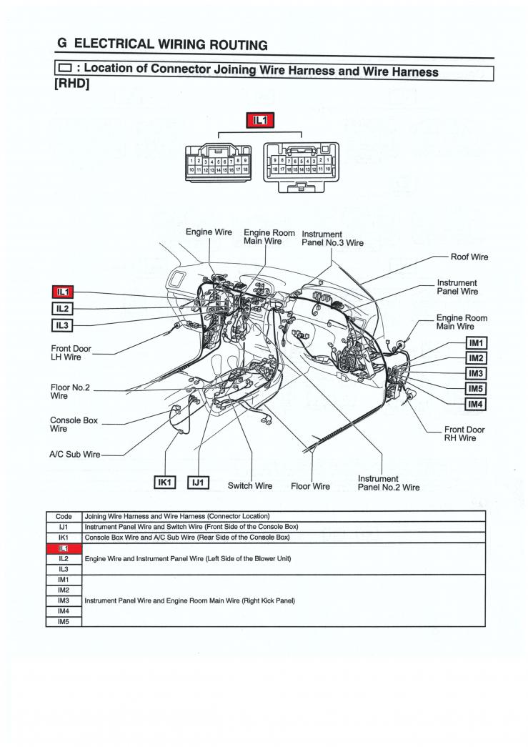

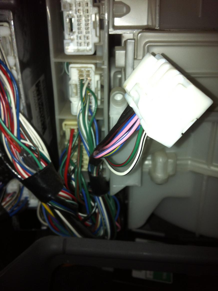

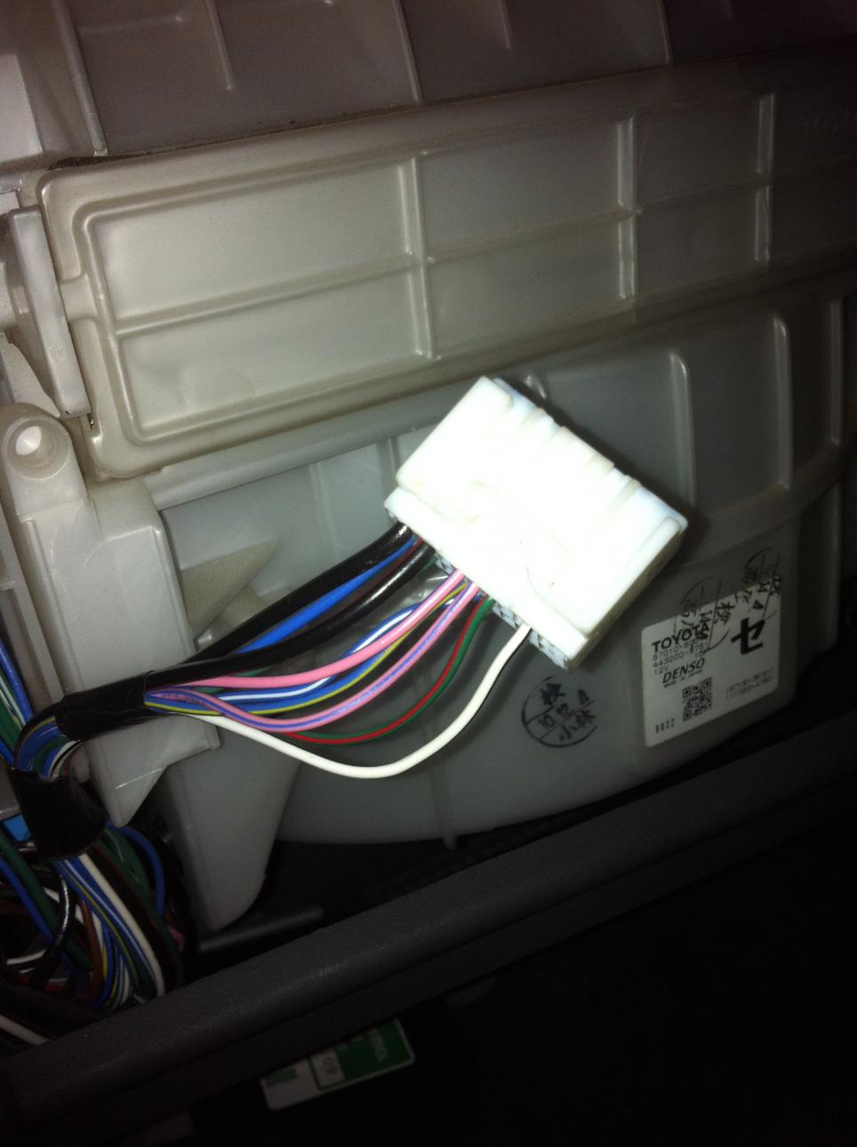

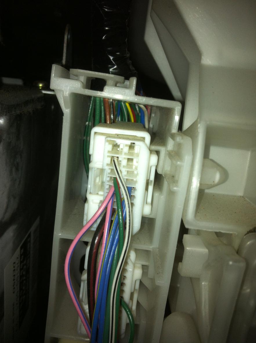

From what I’ve seen there are a few different brands available that can do this. I think any of the electrical speedo correction devices will work, the key is putting it in the right place. After digging up some electrical schematics I found the easiest place to hack into the signal was at pin 5 of connector IL1 which is located on the passenger side on the left hand side of the aircon filter behind the glove box.
