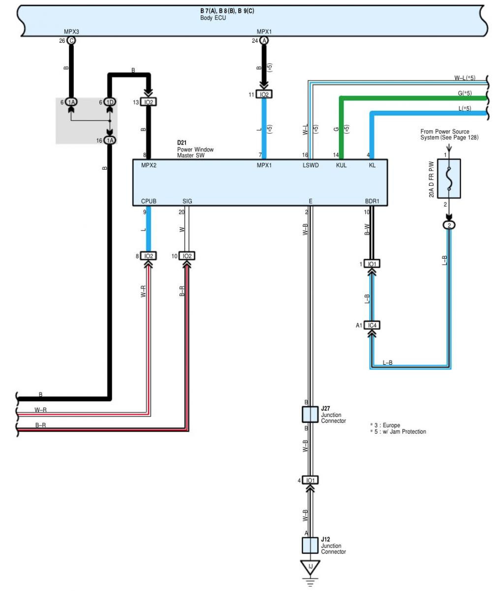

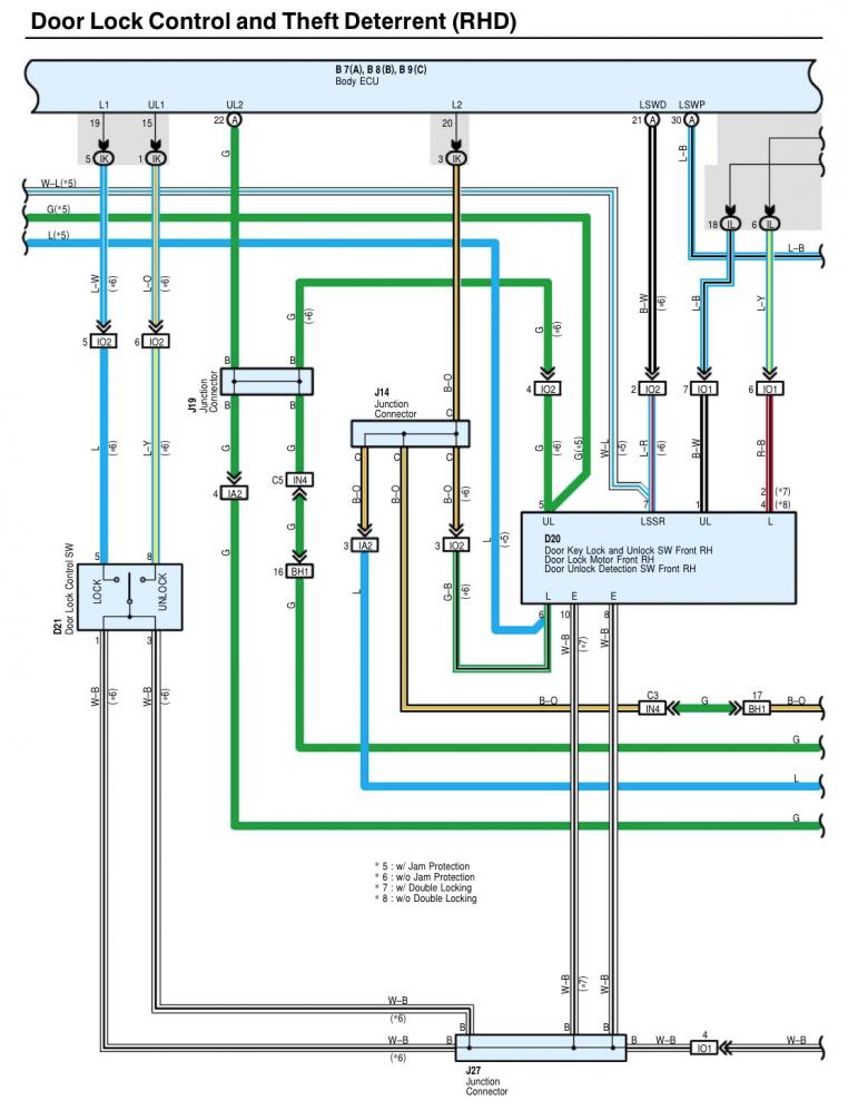

See attached wiring diagrams for the explanation below...
When I measure the voltage output pins 5 and 6 of the "door key lock" D20 (figure 2)(which I assume are the low current wires activating the lock/unlock relay in the body ECU --> correct me if I'm wrong), both have an output of 0V --> 1V when pressing the door switch (respectively lock, unlock)
1/ Can I connect the aftermarket system with an output of 0-->12V to these pins (pin 5 and 6 with 0--> 1V output) or will this damage the body ECU?
2/ Also, I'm a bit confused with these wires running to the body ECU (figure 1 pin A24 and figure 2 pin A22), because if I disconnect connector A the whole central door locking system still works... How is this possible when these are the wires activating the door lock/unlock relay? Where am I wrong?
3/ I would like to position the aftermarket system behind the drivers side kick panel and it would be easier to connect the required wires to a split/junction box near the body ECU. Given that my assumption in question 2 might be wrong, which wires/pins should I connect it to?
