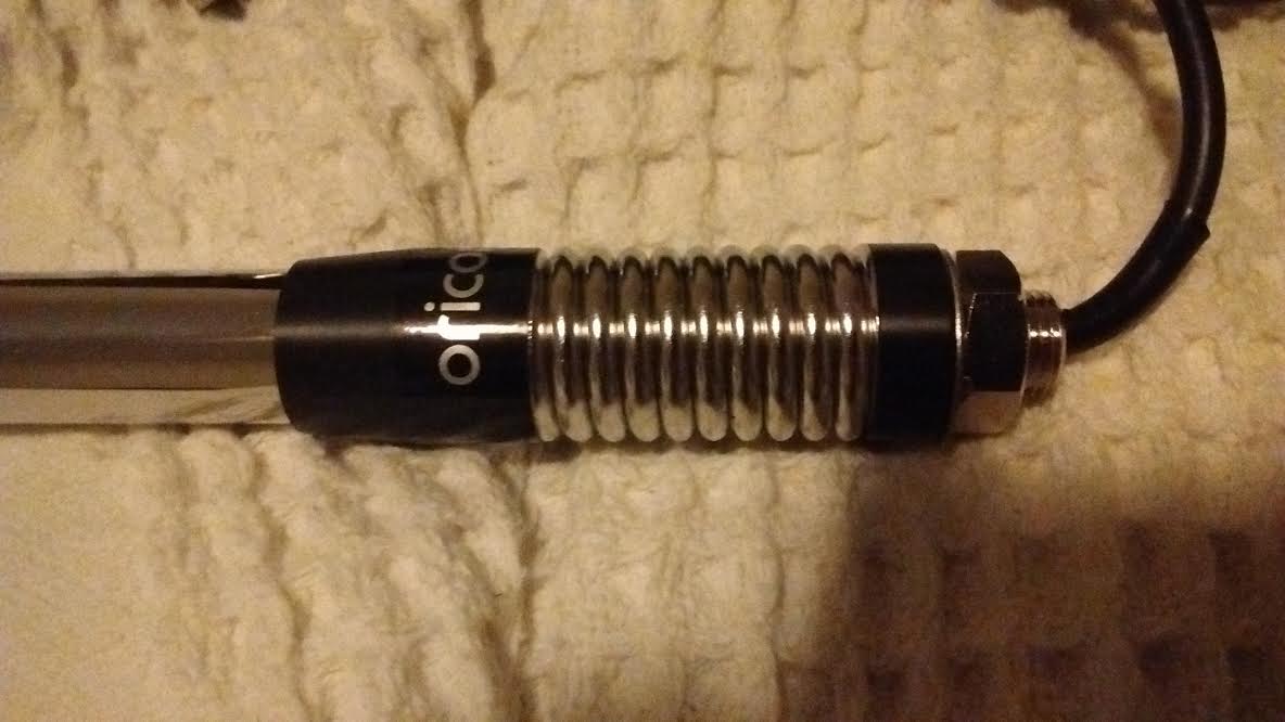

I think I am going to hard wire to the main battery, and turn off when not in use. I am going to screw my antenna to my bull bar as it has a mounting spot. Should I anticipate problems with a bullbar antenna mount on the Prado (the bar seems to vibrate alot!)? I will poke the antenna wire and power through the (legendary) passenger side firewall grommet. I pulled some fat wires through this to charge my trailer batteries.
