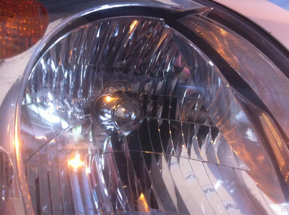

            Wardos, My driver side does adjus anything either.... I need some pics!
              Hi MidLifeCrisis, I will take some pics to show you what I mean when I get off work. It looks like I will have to remove the light from the vehicle and somehow check the insides of the headlight assembly, something is not right with the inner workings of the adjustment mechanism.

                    Hopefully this comes out ok, but you should be able to see that the inside reflector is not sitting properly within the light assembly.
