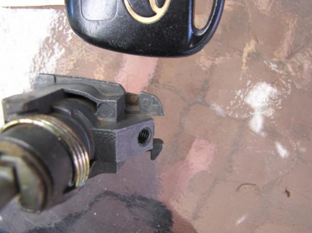

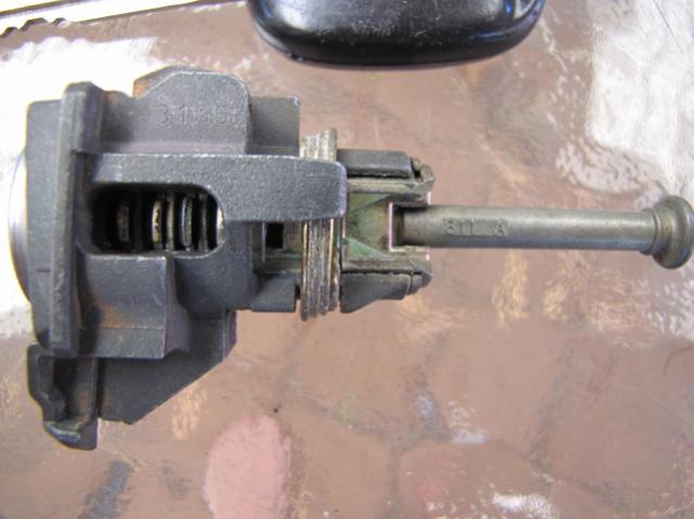

    Since the Toyo dealership didnt provide me with a key code tag and havent recorded it on their data base the 'Lack of Service Department' said to remove the barrel and it will be printed on the case somewhere
    I'm assuming it is this one stamped on the side in the right hand pic.
    There are two other numbers cast on the case and shaft (see below)
    Anyone else had to do this before or know which number it is?
    IMG_2010_1 (left photo)
    IMG_2009_1 (right photo)
    White 2003 V6 GXL, 4spd auto, Vapor injected LPG, Autocraft Prem Billstein 2inch lift with poly air-bags
    I would say its the 31?5 #Toyota should have a record of the key # on their computer if you give them the VIN #

          Hi Billy try http://www.a1locksmiths.com.au/ they take locks out all day to get the key # of cars with lost keys ect .
            I was just visiting a Toyota dealership, in Sydney to pick up some parts for a current project, and asked the question about the #9999 on the lock, and YES, that is the number that a locksmith would use to cut new keys. He also verified it with someone in the workshop.
            He said Toyota might be a bit fussier in terms of proof of who you were etc, but said that a locksmith could do it from that number, and confirmed that it was on the Toyota database, not a local dealer database, which again is a simple dealer online enquiry. He implied that any dealer could do it.

              After a bit of mucking around I ended up getting A1 locksmiths to get the code of the origanal key and they did this for no charge .Now I can give this code to the ebay lock smith and get a new key.
              A1 reckons
              -Toyota dont provide codes with their keys anymore
              -Toyota dont stamp Key code numbers on door locks or anywhere else on later models vehicles(not sure on what years)
              -Toyota key code numbers are 5 digit and start with 5 or 6
