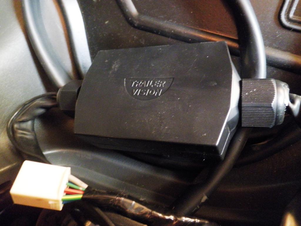

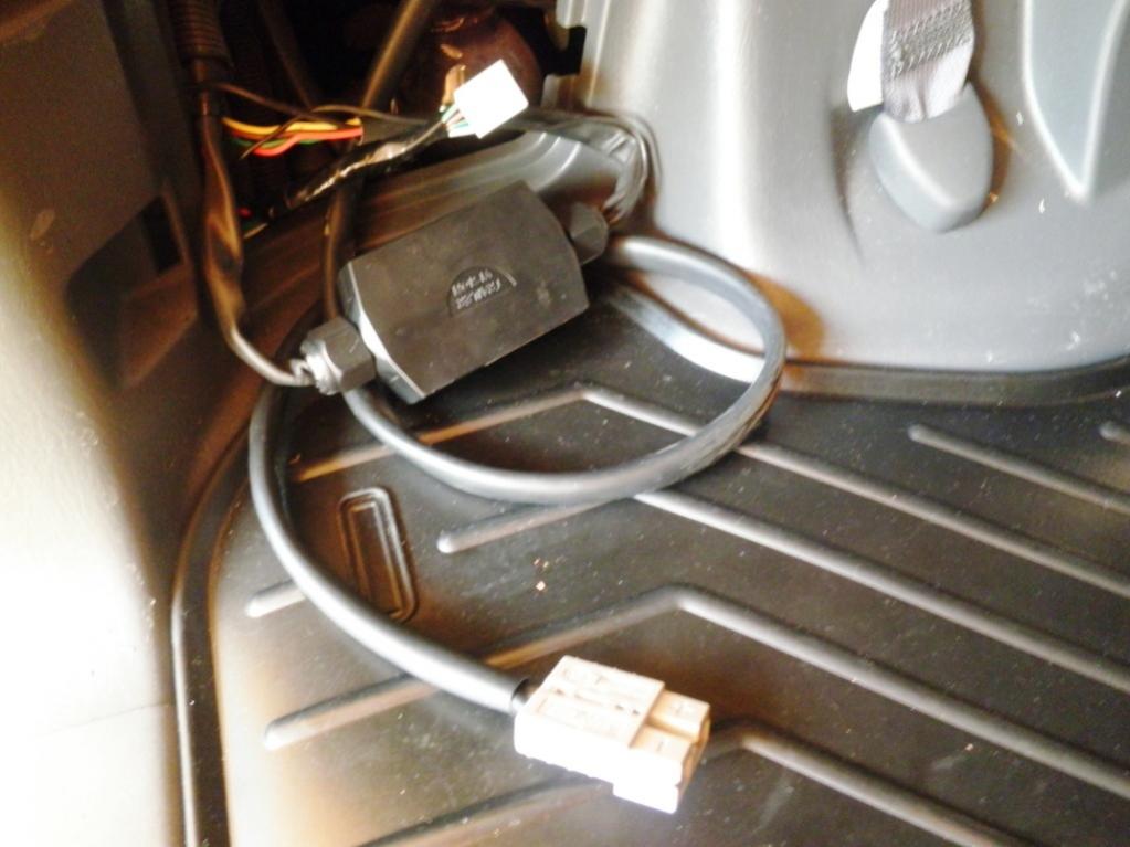

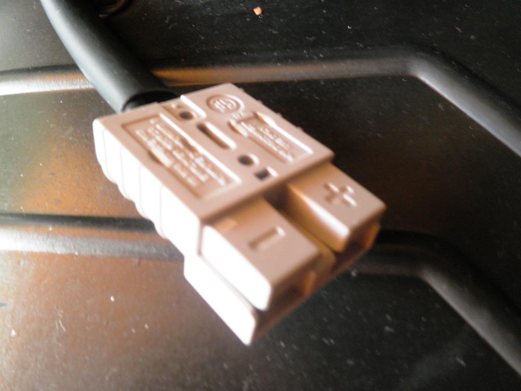

    Hey everyone.
    Purchased Prado recently, no manuals, any ideas with the pictures attached what these are for exactly. Located in jack compartment of vehicle back left.
    Obviously, one to do with trailer, but any idea how it works.
    Figured the positive / negative point is for a battery or mini fridge - any ideas.
    The other little white unit - I have no idea.
    Being a clown, I would appreciate some assistance.
    Regards
    Clown
    Found this http://trailervision.net/?products=t...-safety-system
      The white plug is a Anderson plug for fridges and the likes
        The Traikler vision seem obvious from the post above. I suspect the anderson plug is the trickle charge for a battery in a camper. Look under your bonnet for any unusual set up off the main battery to a Projecta / redarc or simlar unit that allows the trickle charge to flow to that plug.
        mlc
          The Trailer Vision setup is great. I have it. There should be a grey coloured cable (around 4-5mtrs) which then terminates at a small display module..... 5 LED lights (Brakes, Turn, lights, Electric brakes etc) If they don't light up, you have a fault.
          [color=#0040FF]Rob[/color]
          [color=#0040BF]2012 Altitude D4D &
          04 Jayco Eagle Outback[/color]
            I wouldnt be surprised if the small display module is missing. The previous owner (or dealer) tends to remove this stuff prior to selling which essentially renders the unit useless. (is it there ClownCar?)
