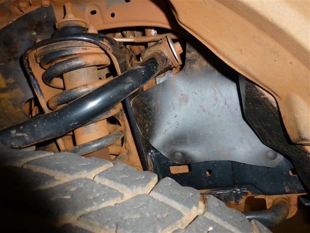

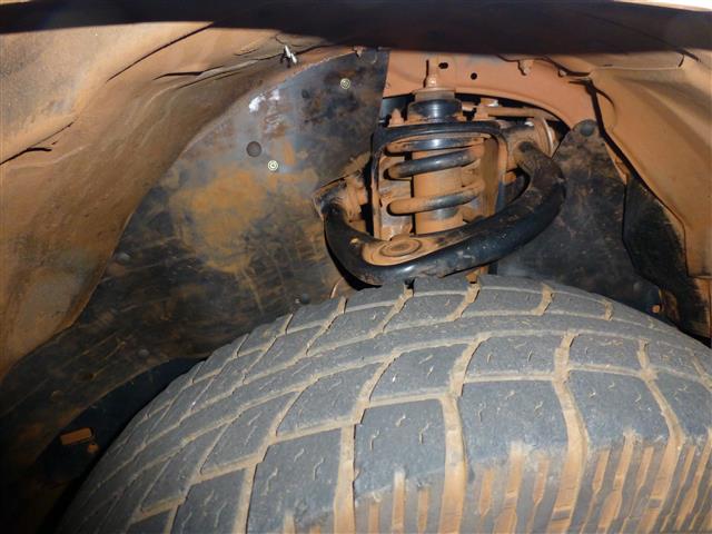

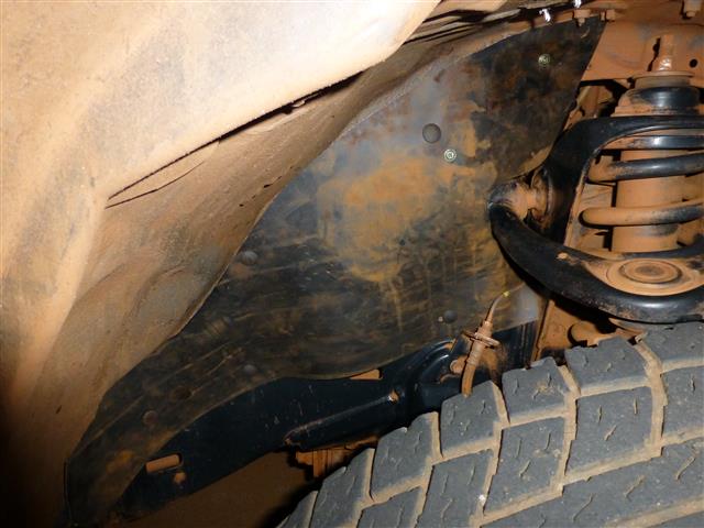

        I just replaced mine today, I had the originals as a pattern but decided to modify to get better coverage, I will try to take photos and post shortly. The originals are rubbish and just disintegrate in your hands.
          Just took some pics, hope this works.

            Thankyou Brett! They are perfect.
