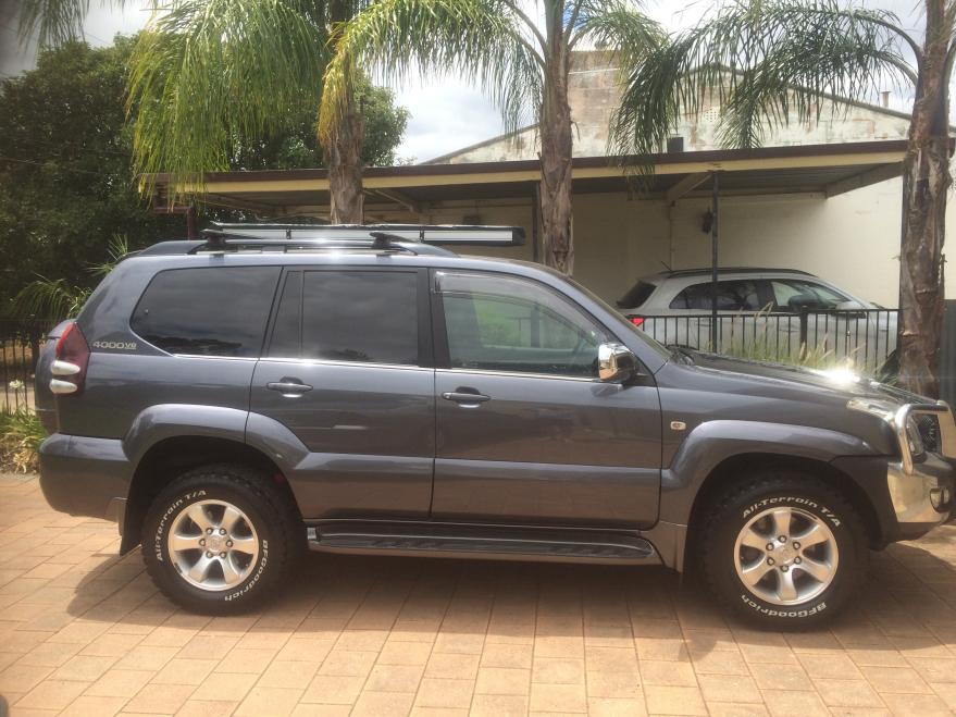

                  Hello all, just bought a full set of these from Amayama Trading. Ordered and received in just over a week ex Dubai and full genuine Toyota parts. I got mine for a Lexus GX470 so they are chrome looking (similar to the very last of the 120 series Grande models 2009 only). All up $240 delivered to my door and only took 45 minutes to fit.
                  Here are the part numbers for all of them including the rear qtr window:
                  Toyota 7566060070 MOULDING
                  Toyota 7567060070 MOULDING
                  Toyota 7572160080 MOULDING
                  Toyota 7572260080 MOULDING
                  Toyota 7571160080 MOULDING
                  Toyota 7571260080 MOULDING
                  and some photos of the end result.Click image for larger version
