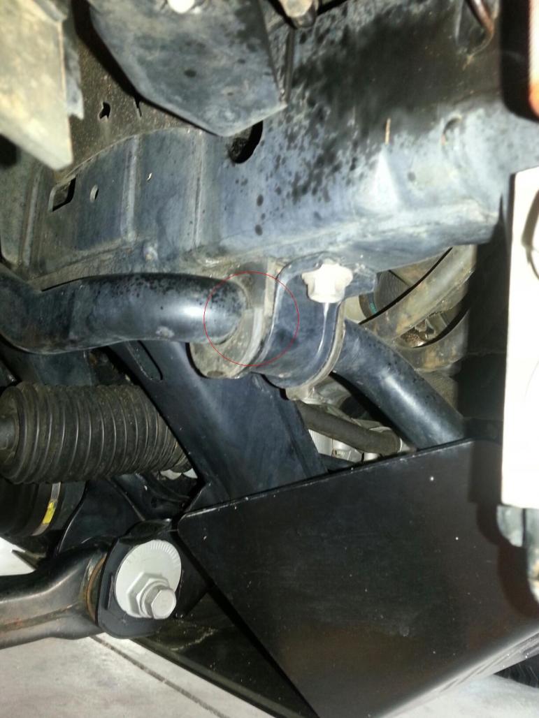

      The only thing I can find is a tear on the sway bar bush (hopefully attached photo will work). Should I get the bush replaced??Click image for larger version
        That tear in the swaybar bush looks like the normal split required to get the bush around the bar. Is the swaybar too close to the suspension?
          Thanks Andrew,
          The other bush looks un-torn so not sure if that means anything? So you reckon don't bother changing it?
          I don't think the swaybar is too close to the front strut/spring but I'll have another look tonight. The clunk isn't too annoying I'm just making sure it's nothing sinister. My initial thoughts were that it might be the ARB springs settling after a drive but now I'm having second thoughts.
            Just had a look at my sway bar bushes and the driver's side looks exactly like your pic. On the passenger's side, the split is behind the sway bar and is not so easy to see. This is split is normal.
                  Andrew the sway bar is pretty close to the suspension so much so there are little marks on the sway bar probably from suspension coming down. Not a lot but they are there. Don't think this would cause the noise though. Any way of moving the sway bar s bit?
