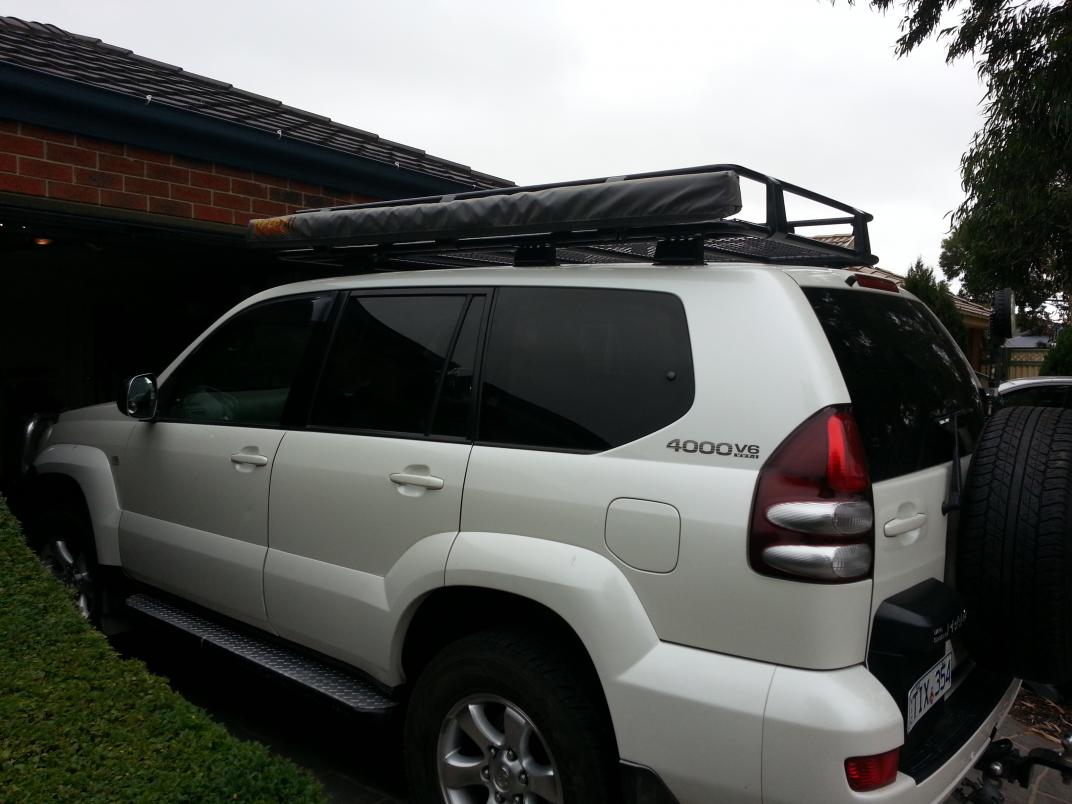

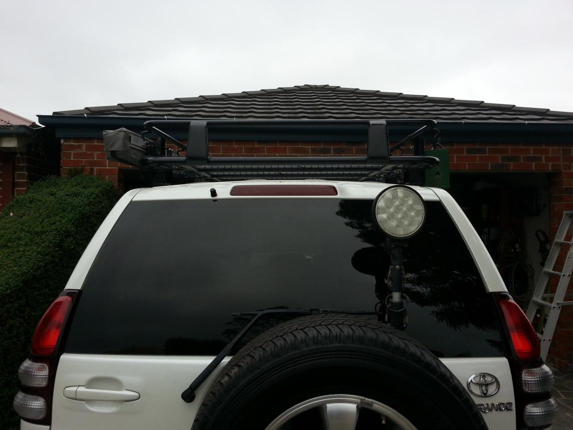

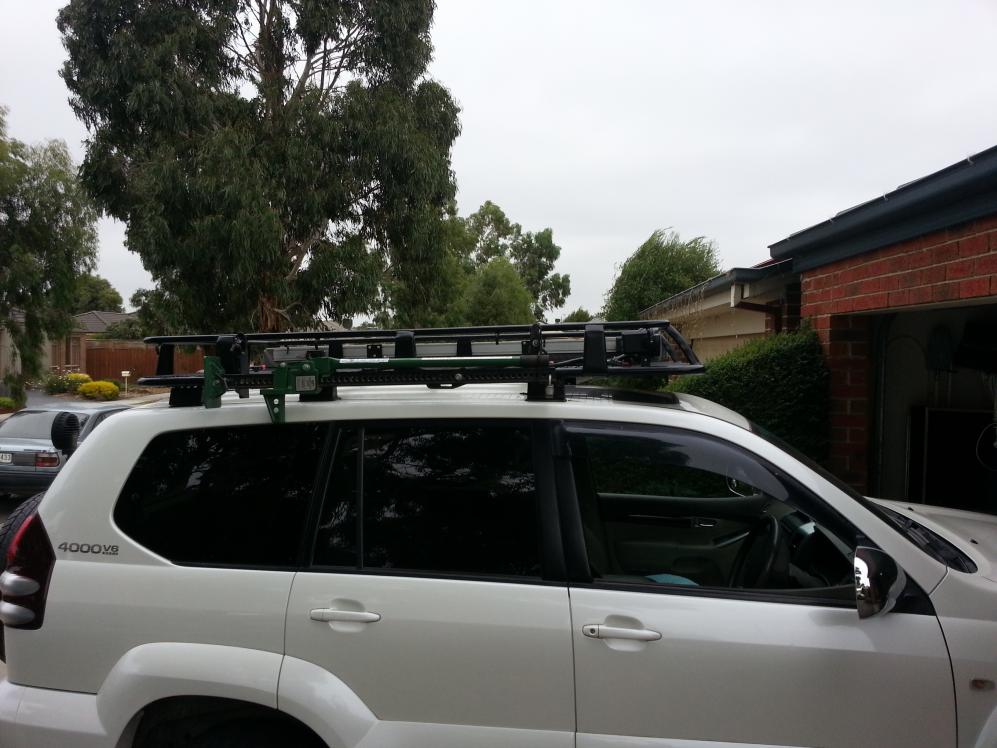

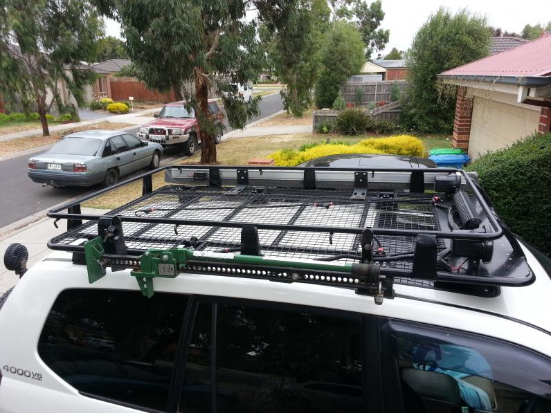

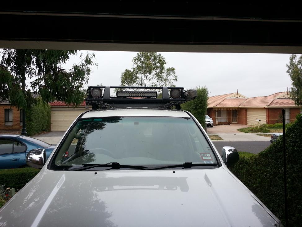

    Was wondering if those here that have the tigerz11 / roo systems rack fitted ( preferably the flat rack but any will do to get an idea of size ) could post up some pics both side and rear view. am wanting to see how the 2100 x 1170 fits the roof of the 120.
    if anyone can help it would be appreciated
    Sorry not the flat rack,but same size
    Crappy day for pic, but hope it helps you out

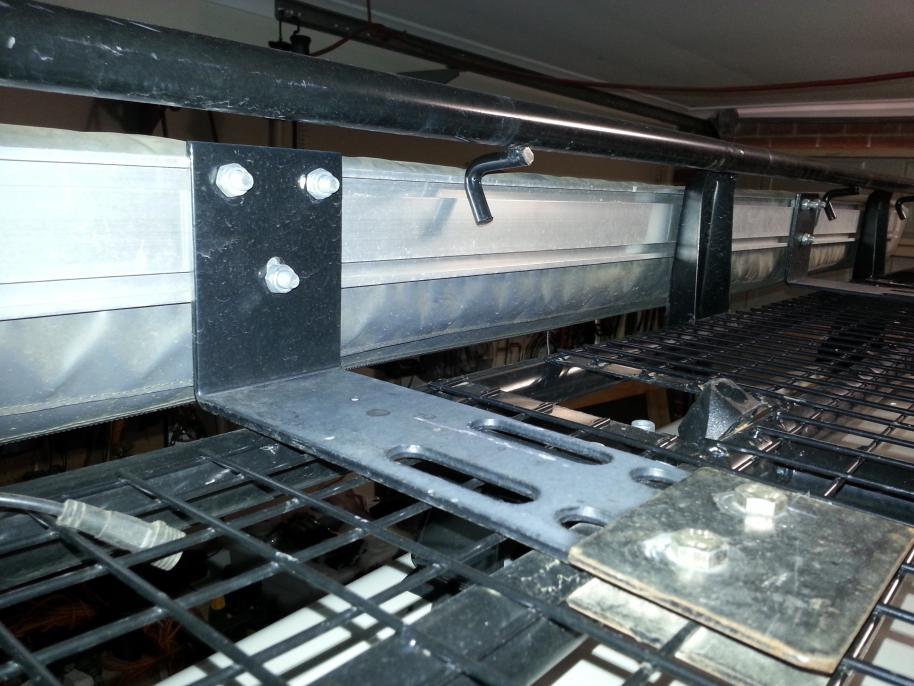

      Do you have a close up of the awning mounts and how they connect to the rack?
        Barcode.
        What I have is a 25x5 piece of Stainless bar.Bent to the height of the standard Awning mount bar.I have then bolted it to the flat plate at the front and rear of the rack.I have the Powerful 4x4 tent rack.Check out my build thread.
          This is it

              thanks exactly what i was looking for. wasnt sure on width and length of their rack and they wouldnt trial fit. thought the width might be a issue but not as bad i was thinking but think i would have to shorten the length a bit to be happy with it not creating a wind drag off the windscreen
