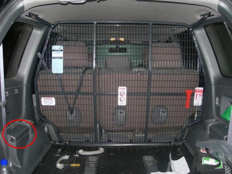

    G'day,
    I purchased my 120 Prado 2nd hand a few months ago and I cant for the life of me find the covers that go in place over the hinges when you remove the 3rd row seats. Can anyone please shed some light on the items for me?
    Can you tell me if the covers are attached to the trim and hinge back in place when the seats are removed? Or are they removable and the previous owner has lost them?
    I’ve tried the many wreckers here in Darwin (all 3 of them ) and there are no parts around (the one i did speak to told me they sell them with the seats?). Looking about I can’t find the official part number by tirelessly looking through toyidy.com or some other parts sites.
    If possible can someone have a look under the cover on theirs and let me know if there is a part number printed there? I know its only a small cosmetic issue but its driving me nuts because they are missing.
Name:	Prado Hinge Cover.jpg
    That part is totally removable. Will try and find a part number for you but it's getting harder now without diagrams on toyodiy. Hopefully other wreckers will have one.

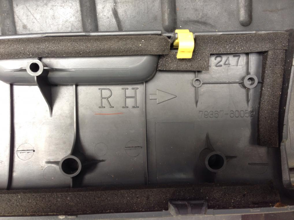

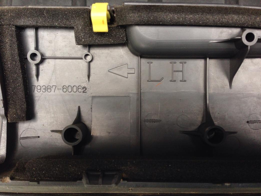

      Part numbers printed on the inside of the part are:
ID:	647705Click image for larger version
      I think you need to A0 or B0 to the end on Amayama eg: 7936760052A0. I don't understand the variants eg B0 vs A0. But E0 is for the 4runner
      These are for a 2008 120
