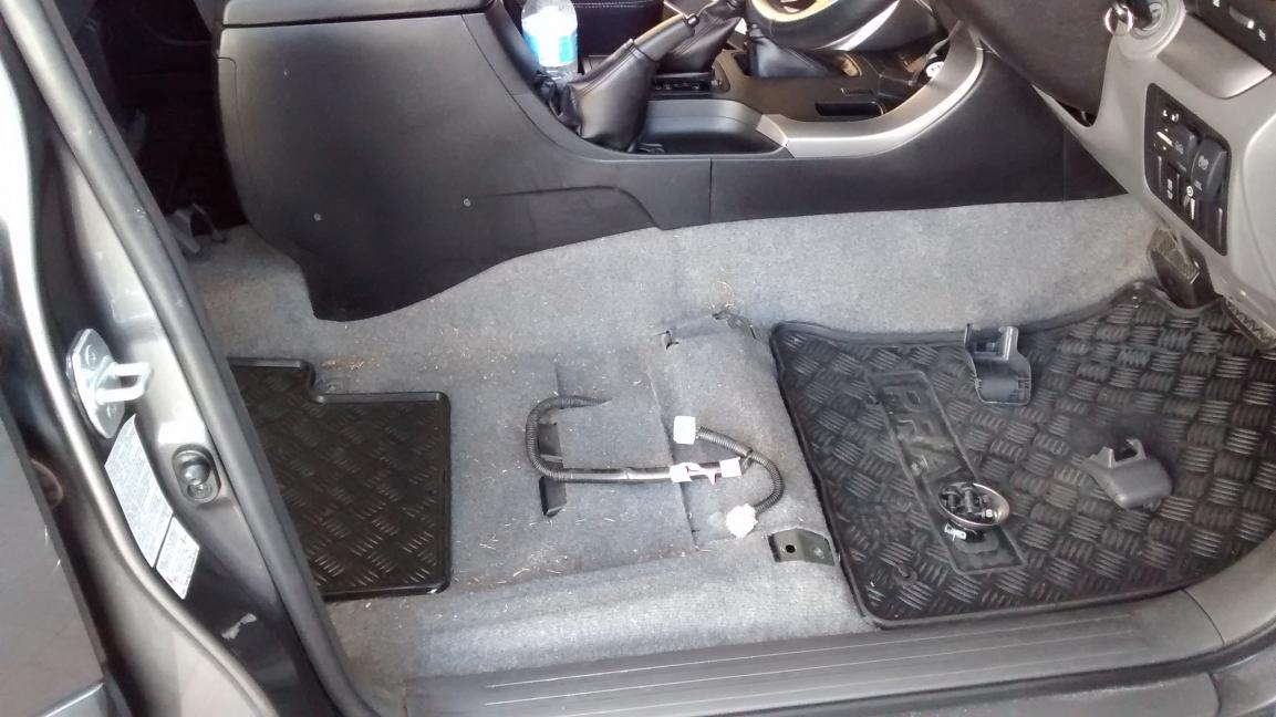

      Firstly, removed the driver's seat to make sure the amp had enough space.
      Seat taken out.

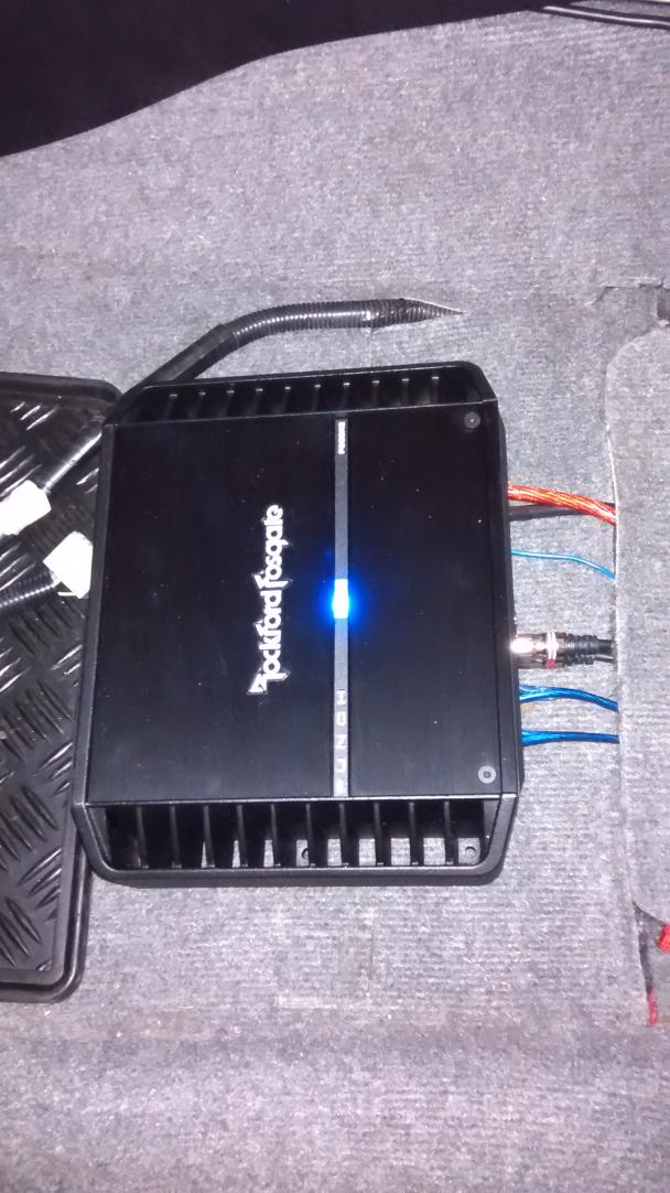

      All wired up.

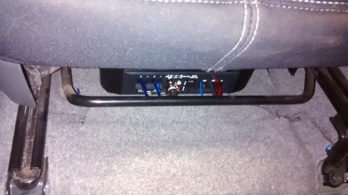

      Seat put back in place. All hidden away nicely.

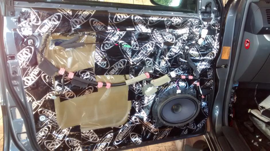

      Here's the door with the stock 6x9s and my dynamat job, looks shit, but I cut it into small manageable pieces for two reasons. 1. Because I wanted to keep the wiring in place where it was due to limited time and 2. to limit swearing when things go inevitably wrong and it sticks to something it shouldn't. i also applied a fair bit of it on the inner skin that I could reach through the hole where the speaker goes.

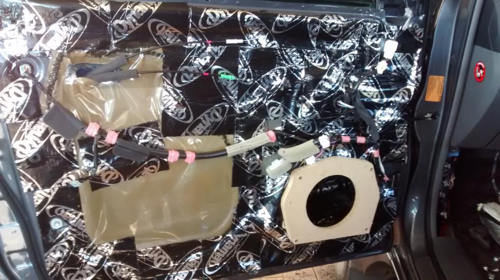

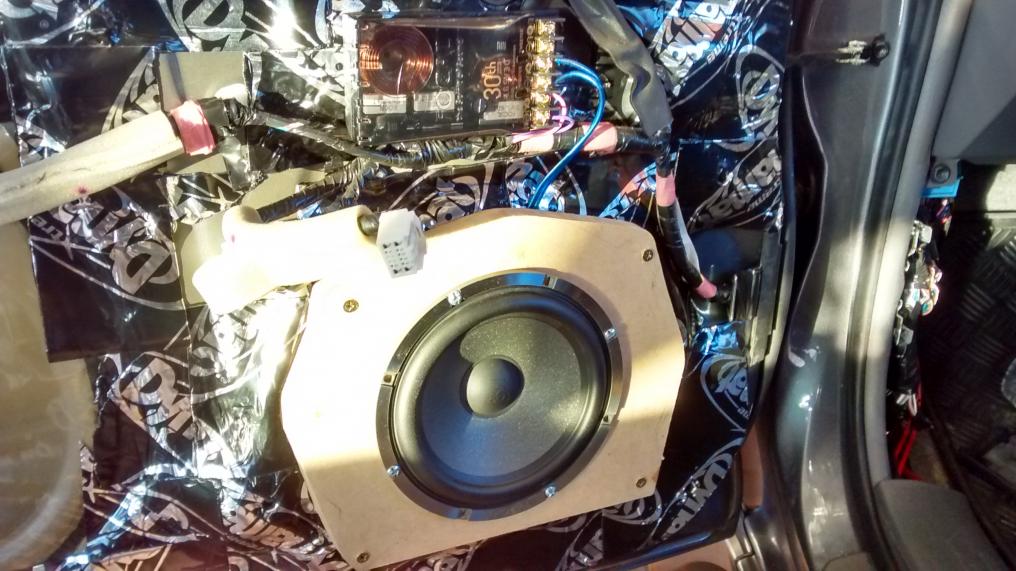

      The MDF bracket in place.
        With the speaker and crossover in place. Crossover is just stuck to the door with heavy duty double sided tape.

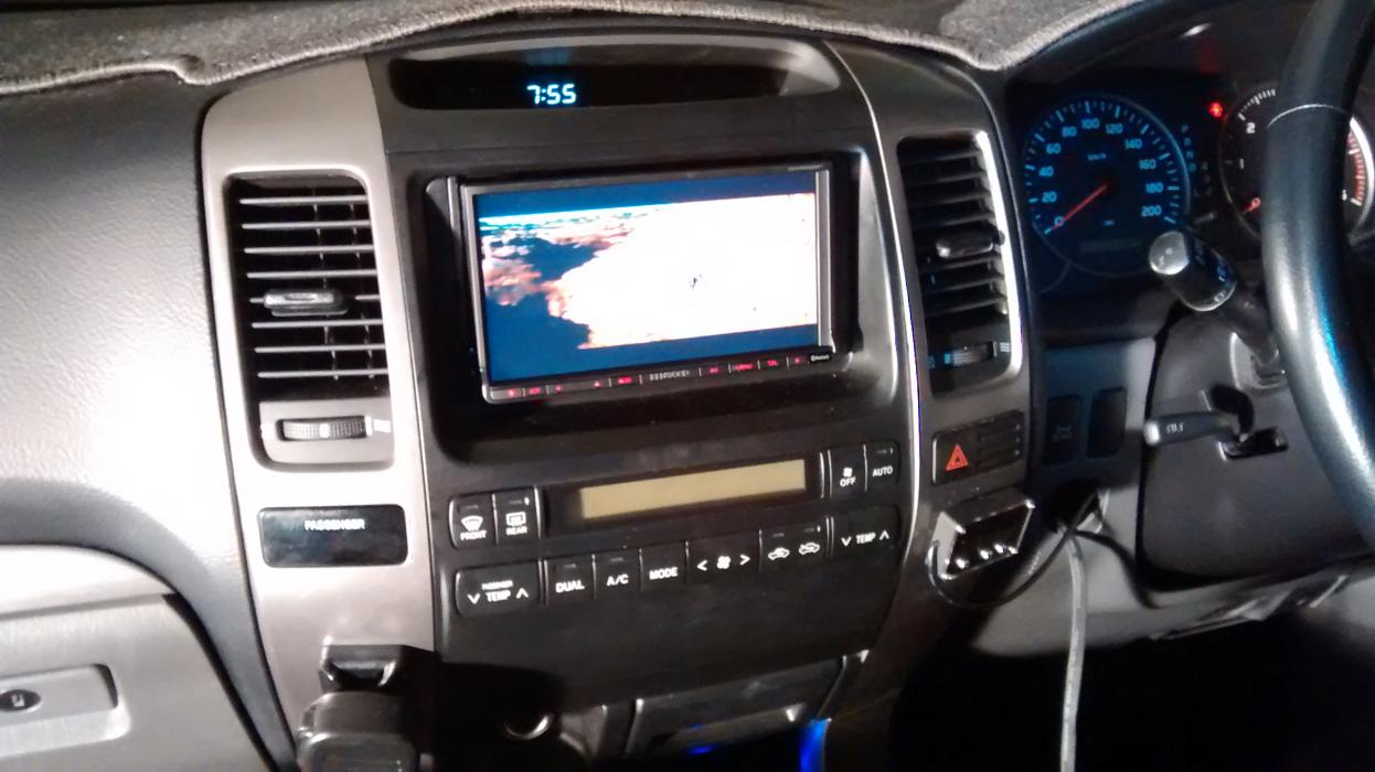

        Then with the new headunit in place with all panels back in ready to go.
