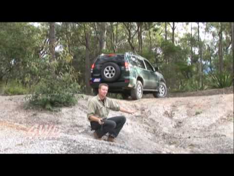

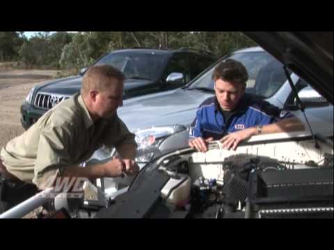

      I don't have a locker but this is a pretty good demo:
        Part 2:
          Traction control is good, a locker is better.
          The TC is a bonus as its always on so kicks in when didn't realise you would need help. But the locker is 100% but only when you select it so you might use that on your second attempt!
          No reason you can't have both, once the locker is engaged that will negate the TC on that axle as you wont get wheel spin.
            As mine is a gx prado 120 it had no traction control and it would basically get bogged as soon as it lifted a rear wheel so a locker was a necessity. I haven't looked back
              Haha, I just watched those vids.. some good examples in there, but I gotta laugh at the "maths" that the host does at the end of Part 2 - he says that because the Grande is $20k more than the GXL, but the ARB lockers are only about $3k, then traction control costs $17k more than lockers and doesn't give you as good capability..
              I'm pretty sure the extra $20k for the grande is for more than just the traction control (think leather, sat nav, adjustable suspension, etc, etc), and not to mention that traction control was available with Option Pack 1 for the GXL (but I don't know how much that option set you back)..

                          thanks fatboydave
                          the videos convinced me
                          i nearly got stuck in deep soft sand
                          front ARB locker ordered to help the OEM rear locker
