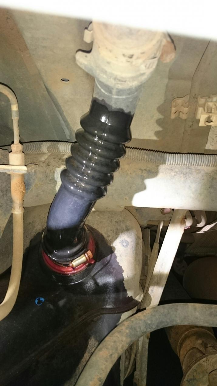

    Tonight i smelled a petrol smell and consequently found a small quantity of petrol leaking from my vehicle.
    Upon climbing underneath i have been able to see there is a hole in this hose which is allowing some petrol to leak out.
    Going to have to get this sorted first thing in the morning but any help identifying exactly what hose this is would be appreciated.
    If i am to get it replaced, will we need to empty the fuel tanks prior?
    Picture is attached. It was taken by crawling from behind the car looking towards the front. The hose seems to be attaching the two petrol tanks together? Or to the fuel filler i am not sure?
    2004 Black Prado Grande
    That looks like the filler tube. Check the clamps are tight. Does it only leak when you are filling and tanks are full?
      had same problem a few years ago , tube was cracked on mine , easy replacement.
        No its a constant leak which made me think it was the tube between the two tanks.

          Sounds like its cracked...
          Needs replacing.

            Just as a follow up - Yes the hose had a crack in it. Was a simple replacement job. 2 hose clamps. 1 hose only available from Toyota at $85.
