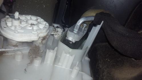

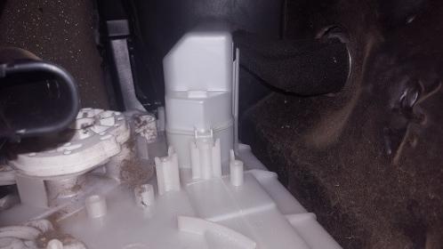

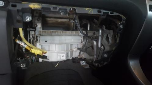

        Hi Dave,
        There are indeed models that require full dash removal, however I've just done my 08 Prado 4L V6 (GRJ120R) this weekend and it was pretty easy and does not really require a ton of courage.
        Total cost: $340 (Cool Drive Evaporator EV3320 $200; Aircon regas @ Headland Auto (Pressure test, labour, gas, oil & fluoro dye) $140
        I also replaced the cabin air filter for $42 from repco although to be honest the quality of the repco filer does not seem as good as the original (time will tell I guess)
        Here are the steps I followed (or at least should have followed):
        Passenger Side
        1. Remove the glove box (+- 6 screws)
        2. Unclip all the cables and remove the car computer (I got it out without removing the computer but I needed some beers to calm down, perhaps that was a bonus)
        3. Remove the fan unit (1 nut, 3/4 screws) it slides out to the left and may require a bit of patients without the computer removed it was almost impossible
        4. Remove the cover for the evaporator (6/7 screws)
        Engine:
        5. Degas by pressing the valve in (use a rag to make sure you don't spray oil in your face)
        Drivers Side:
        6. Remove the plastic cover over the aircon pipes (1 screw)
        7. Remove the 2 hex screws that are holding the evaporator in place
        Passenger Side:
        8. The evaporator will now be lose so you should be able to pull it out easily
        9. Remove the slide at the bottom of the evaporator and put it onto the new evaporator
        10. Remove the old sensors from the evaporator and put it into the same spot on the new evaporator
        11. Slide the new evaporator into place
        Now go though all the steps in reverse. I only removed the computer at the end when I could not get the fan unit back in easily but it would have saved me about 20 minutes if I had done it at the start. Total time took about 2.5 hours. The prices you've been quoted don't sound too bad however.

        Hi Thomas, just wanted to say a BIG thank you for your post mate. Tackled this on Saturday in my GXL and pretty much had it done in about 2.5hrs.
        The compartment was full of crud, obviously previous owner had run it without cabin filter...no joke removed a good handful of rotten twigs, leaves and other crap. That junk and the moisture was right next to the leak. Also, top hex bolt was not exactly super tight either, so glad to have cleaned out, replaced and torqued up the bolts that fasten the evaporator.
